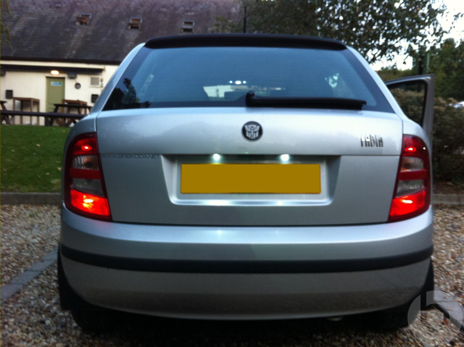

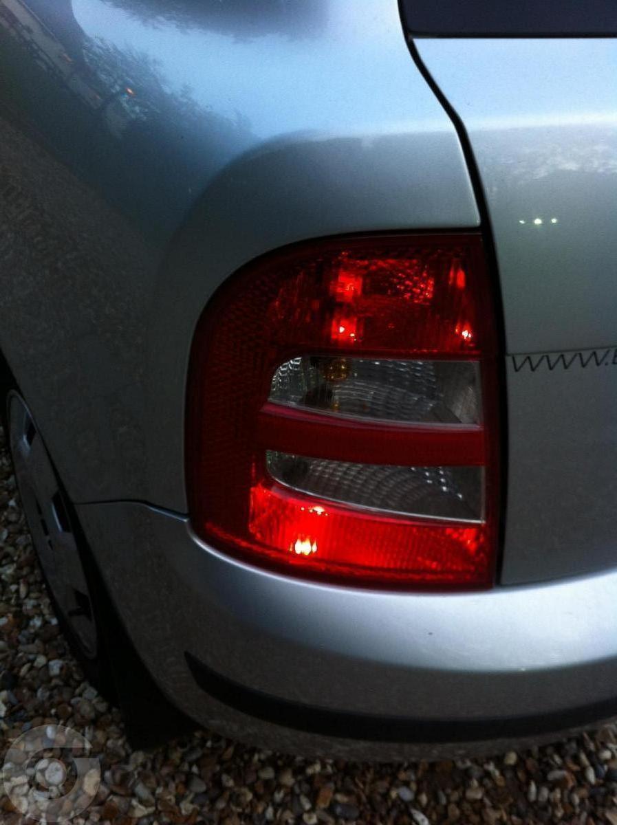

HI All just got my LED brake light bulbs from autobulbsdirect.co.uk and when I turn the ignition over to position 2 and when the car is running the bulbs light up very dimly. anyone know why and how it can be fixed.
Some pics

^^ as above. LEDs have very low power consumption so they dont need hardly any current to light up.
You either need to wire a resistor in or use canbus bulbs. To be fair they're technically illegal to use anyway as they're not e-marked (no led bulbs are).
