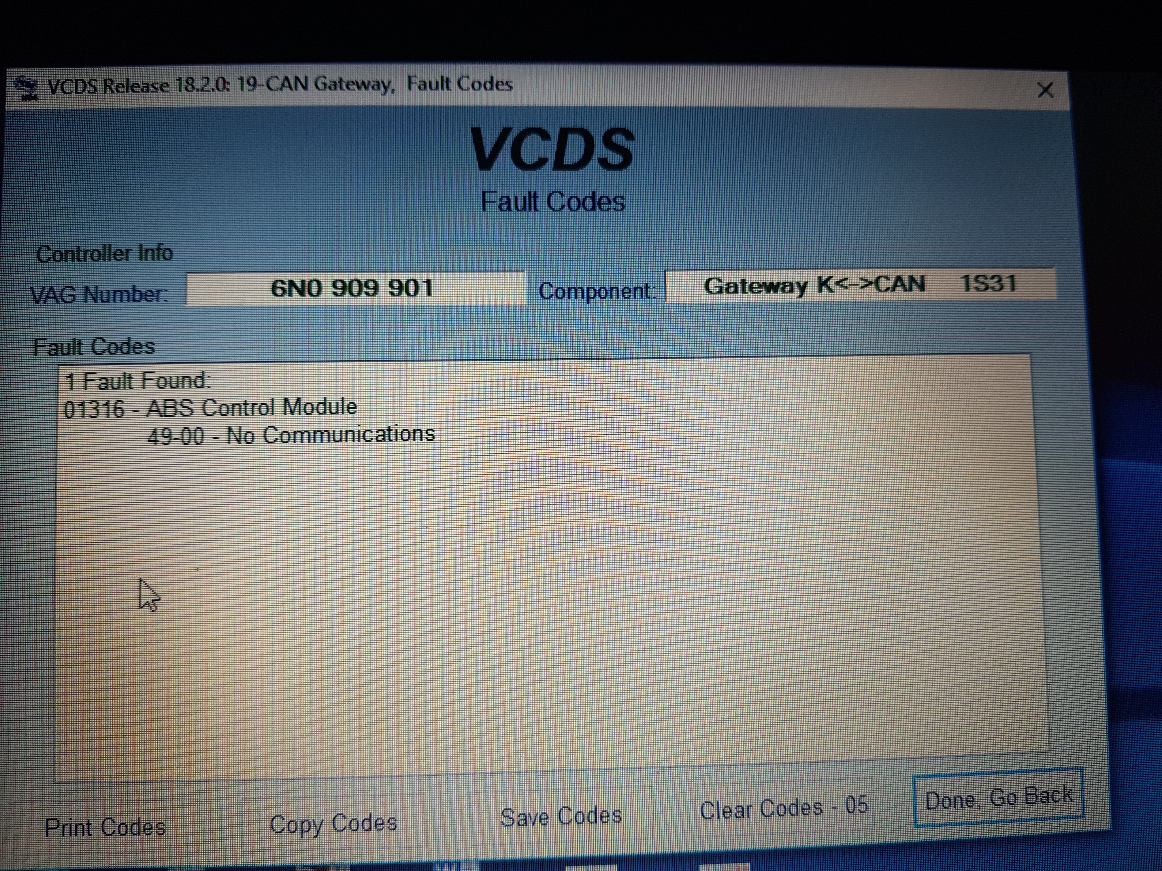

Hello i had the same fault codes  than i follow these instructions and now my abs light is on but i dont have abs modul at all in my fabia. Please help
Skoda fabia 2001 sdi (without abs esp)
That is gateway (19), it is coded incorrectly for a vehicle with ABS.
What should i do now? When ignition is on i have abs and brake light on than long beep. How to disable that?
Re-code Gateway so it's not looking for an ABS control unit that's not there (minus 00002 from the coding)
Thank you. Will try tomorrow.
Did you change the Gateway coding from what is was originally?
I think i am
I entered 00014 and then abs light comes on
