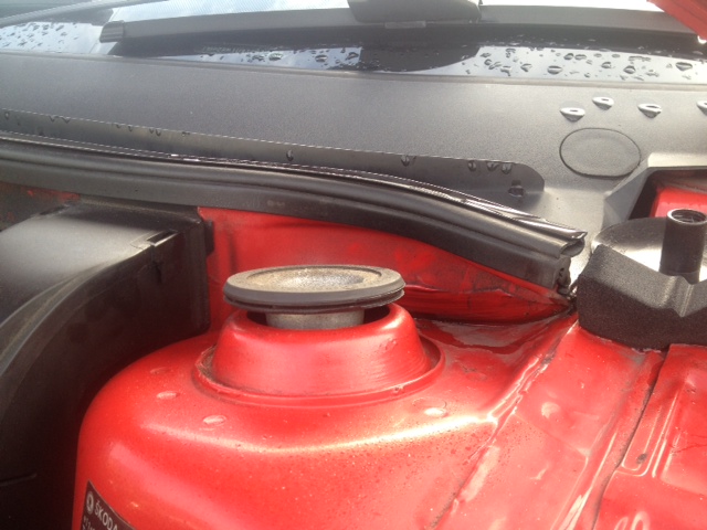

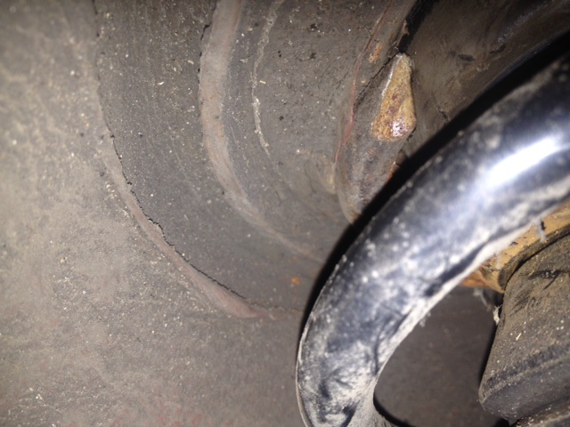

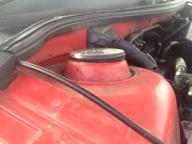

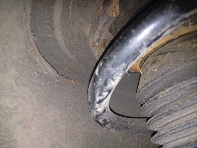

Left home for work one morning this week and got a loud twanging from the front end when turning, so headed back at the end of the road to jump into my other car. While doing so, sounded like something dropped off and rattled down away from the car (like when you run over a large stone in the road).
I think the front off-side spring has gone at the top, but would appreciate someone confirming by taking a look at the pics I took when I jacked the car up this morning. Also the top mount on that side seems to be flush with the body work.
My plan is to buy some H&R 20mm springs and new top mounts/bearings & get my friendly local Volvo indy to fit.
Let me know what you think - has the spring gone?
yes spring has broke
