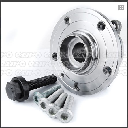

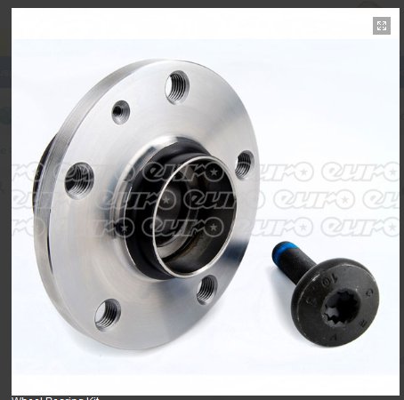

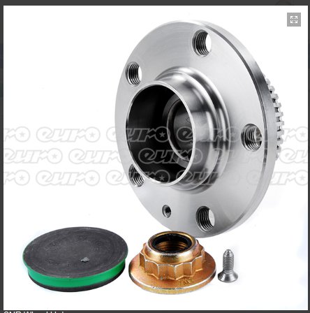

There seems to be some variety of parts - I've just looked at the images on eurocarparts and they have three different sets of bolts depending which one I pick. Heres the photos:
Anyone know which I need? It's a 58 plate 1.9 TDi Octavia Estate.
The top one looks like the right one to me.
OE number should be 1T0 598 611 - the SKF ref is VKBA 3644.
