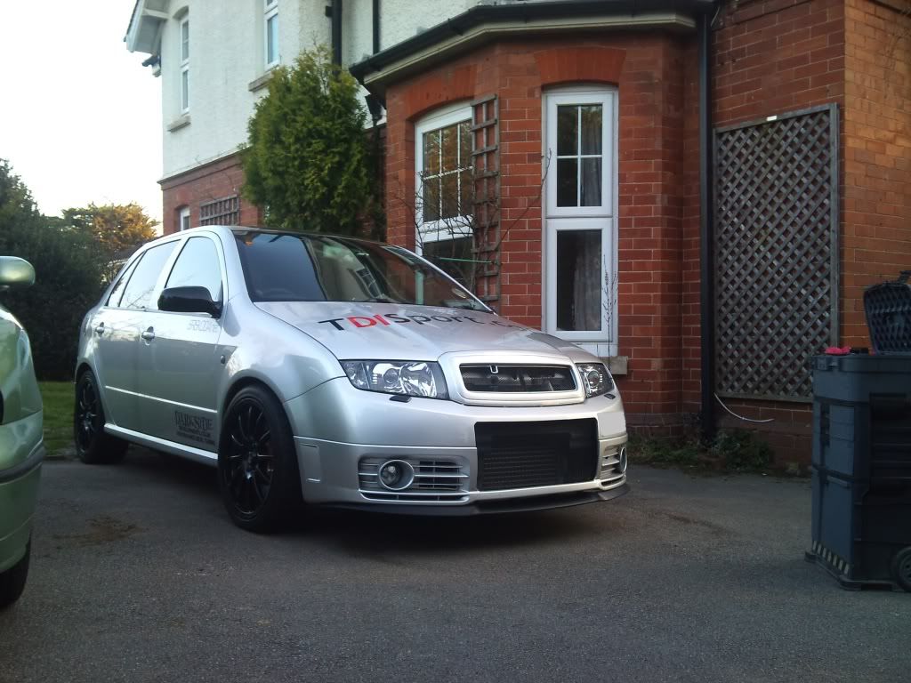

Well, that was easy! Got the toolbox out ready to do battle after work and all I did was loosen off side one, take out top 2, push light a bit more to the outside of the car, tighten up side one, do up top ones again, and bonnet fits nicely between them. Feel a bit of a twonk now for fitting first time without checking grille alignment between them. Need a new grille long term now! :(
Car is looking good on the new lights
