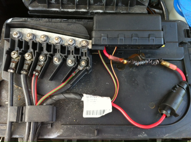

My wife's faithfull runaround is the 2001 Fabia (1.4 Petrol). First hot day of the year and on the school run yesterday, the car overheated causing a minor ovespill of coolant. She called the AA guy and the diagnosis was that the "Fan resistor is burnt". She was shown the terminal wire in the battery connector box (just above the battery) which is burnt oot revealing a sort of melted down plastic on a coil of spring! I have seen it this morning and I have attached a picture of the component.
What is this "resistor"? Is this the automatic timer cut-out? Any help .... will be helpful.

That certainly looks like a burnt out resistor, but it doesn't look standard. What engine code is it (3 character code from options label in boot or service log book) and does it have A/C?

OK, I remember what that is - I've retrofitted at least one. It's a noise suppressor. All cars don't have it and you can do without it unless the fan affects the radio or causes a warning light.
According to my notes it is part number 6Y0 971 037 E and is about £20.
Noise suppressor?! So can I directly wire it (as shown in the photo in the original mail) bypassing the burnt out bit? Will try it out?

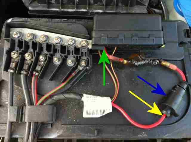

If you look in the picture, the 4mm red wire (yellow arrow) would connect to fuseholder 8 (green arrow) if the suppressor was not fitted. You need to check fuse 8. The black block (blue arrow) on the red wire is just a wiring adapter.
I don't know what the AA man tried. If fixing the fuse and removing the suppressor doesn't get the fan going then you may need a new fan or thermo switch.

Might it be a good idea to find the reason why the condenser has burnt out first before replacing it ? Could the fan be taking too much current?
I would personally check the inline fuse is the correct value and not bunged up with aluminium foil. Also, check the current the fan is drawing with a multimeter before replacing anything. Like RW said it could be a seized or shorted fan.

The fuse 8 is indeed blown. Looks like the AA guy changed it and it blew again indicating that the fan is gone.

Changed fuse 8. Still no fan. Looks like the supressor needs to be taken out OR the fan is blown. Either way I need to take it to the garage :(
The other thing you don't know is what the AA man did. I've seen quite a few where the plug has been removed from the thermo switch or fan to prevent further problems.
