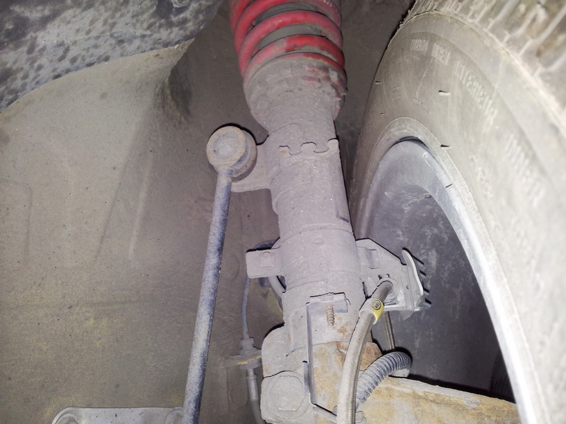

Here is a picture with the clearance of 205/50 R17 tyre against suspension.
That looks gert loads mate :D
Loads of folk run the 225/45/17 bud

I ran 225/45/17 on my old MK1 vRS, on the standard wheels with KW V2 coiilovers with no problems at all. 225 is about the max for the 7J OEM spiders 17" wheels.
Thanks, Mannyo.
Do you remember, by chance, what was the clearance between the tyre and the coilovers with the 225's on?
