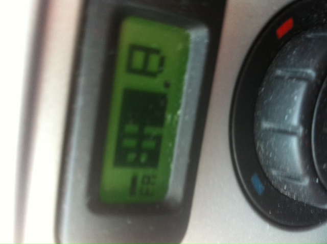

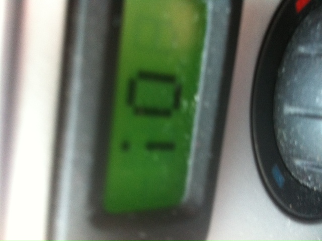

I've just tried the self diagnostic thing: when i first turn the ignition on with the recirculation and econ buttons pressed I get the the first attached picture. The system cycles through the fan speeds etc as expected and then i get "i 0". Is this a fault code?
