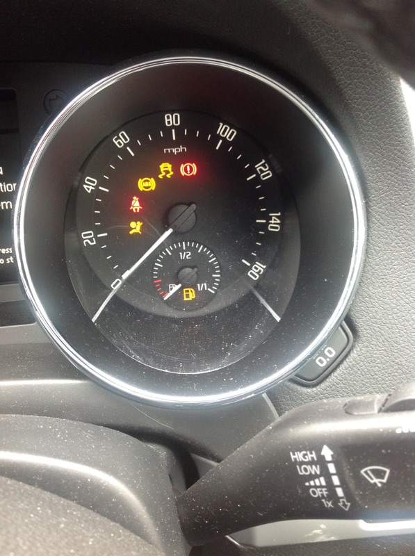

I have been to right connections in Telford this morning and they have recoded the yeti and the ops now works (and shows a trailer when one is connected).I asked them how I know that the TSP is enabled when a trailer is attached - when you turn on the ignition if the orange light with the skid marks on it stays on longer than the other lights then tsp is active.
