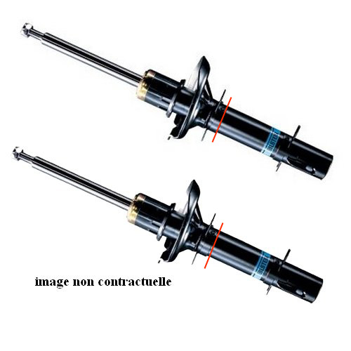

I went to measure them just now and it looked like it was 55mm using a tape measure and eye. So I thought I'd get a little more technical and measure the circumference and calculate diameter from that...
I got 188mm circumference which gave me 59.8mm diameter...
Did I measure the wrong place?
I measured roughly where the red lines are on the standard Skoda shocks.
You need 55s. But seriously - just get some coil-overs rather than spending money on springs and dampers. You're paying the same for fitting either way. Might as well do it properly.

I'm sure about the 55mm bit.
Nicks right. if its a 2.0 TDI its a 55mm strut.
Thank you both for the confirmation.
I'll be ordering some from DP Performance Monday morning.

All fitted now and worthy of an update. 55 mm was the right size.
I had the Eibach / Skoda lowering springs fitted (the red ones for an estate) along with the Bilstein B4's (55 mm) by Midland VW on Thursday. They also did the full geometry alignment for me.
