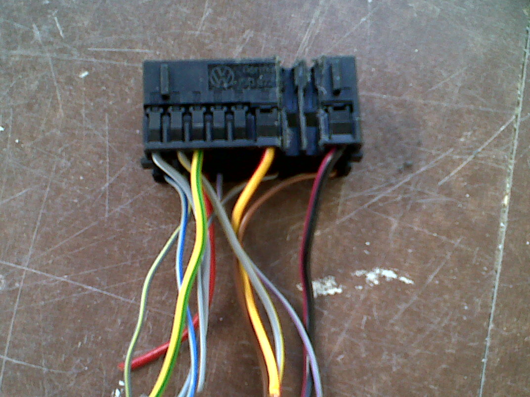

post-87628-0-44501900-1338150321_thumb.jpgso i finally got round to fitting my drls, and following various threads it was quite easy to do.
first off a pair of 'audi style drls from fleabay and fitted into lower grills each side. dead easy!
then getting a wire in place...not so easy but again thanks to forums i found a way!
now the good bit!
there is a terminal on the back of the light switch marked 'tfl' which gives live feed when ignition is on but turns the feed off when lights are turened on. Exactly what i needed!
the 'tfl' terminal however has no wire going to it, so a trip to the scrappy got me this
A light switch plug from a seat. i just cut the plastic to get the wire and terminal i needed and slotted it into the hole in my switch, soldered all bits and hey presto job done!
