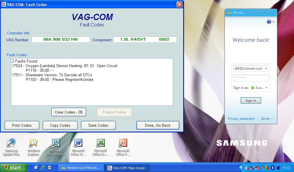

Fault code 17524
Does anyone know what may need replacing if I get the fault code 17524 B1 S1 Open circuit?
I have a Skoda Octavia VRS 03
If it is the oxygen sensor which one should I replace?
Dave
It's the pre-cat sensor or it's wiring/power
Thanks..
Car should run ok at operating temp
