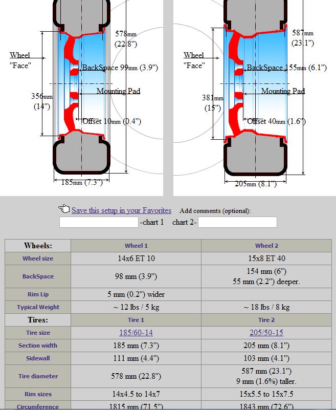

I want to change the wheels and tires on my Fabia. The car is going to be between a Sunday drive and track toy. I can have wheels fitted from 14 to 17, but when it comes to tires, 15 is the ultimate size from what I have seen. The industry have a verity of slicks and simi-slicks. It is extremely popular. Moreover, there is a vast difference in price when jump up a size. Yet, I'm still worried about the high side wall! It is above 10cm :/
What do you think guys?
ive never seen a side wall of 100mm??
