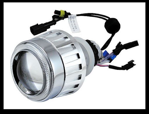

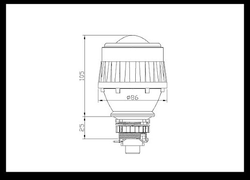

Just been looking at Xenon kits, i've got a kit fitted already 6000k. But just stumbled across bi-xenon ones with hi beam/low beam in one with halo rings aswell. Wants 100 quid. the question is? would i need the xenon headlight unit itself or would these fit? the diagram in the post says they are 86mm wide. Any one have an idea's / have these or thought about them??

You have to split the headlights and typically, butcher (!?) the reflector assembly in order to fit them. That said, a properly set-up set of projectors will easily better the usual HID kit sold for £40!

I would probably try and fit them in the fog light holes. I think that would look good with the halo rings.

It would be much less hassle to simply buy these...

Yes sam, i was looking at these. so im gathering you'd have to buy both headlights. then buy the projectives/bi-xenon bulbs.. yes it may look good but its gunna cost about 300/400 quid! i'll stick to the 40 quid hid kit haha :)

Buy the headlights, and a HID kit with D2S bulbs. Everything else can be swapped over from your standard lights.
Shouldn't be more than £250
