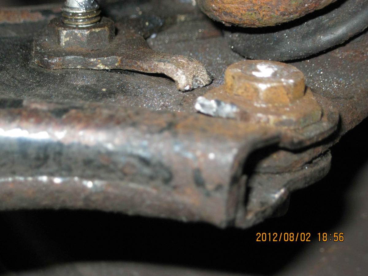

Hi all,
One of the three 13mm nuts on the ball joint keeps rotating and can’t seem to get it out. I have tried plusgas, clamped it down with vice grips and pulling while turning, cut it down with hacksaw, broke the lock plate to unscrew from the top, but it keeps spinning. I’m now thinking of perhaps removing the ball joint itself. Please what else can I do?
Angle grinder, sorted :D
+1 grind the bas. New bolt less than a quid
Thanks will give it a try
