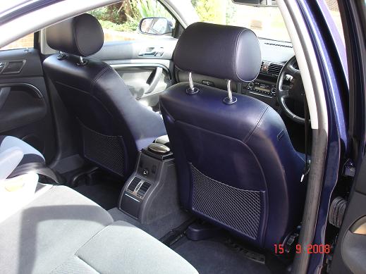

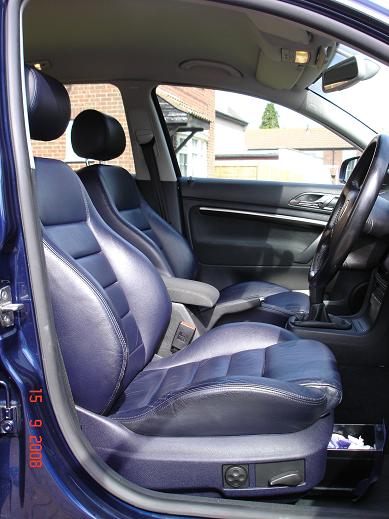

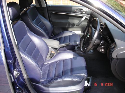

I fitted the S6 seats as I suffer with back problems and the electric lumbar support on the S6 seats helped no end.
Do you have a picture of them fitted?
The rear S6 seats DO NOT fit however.
