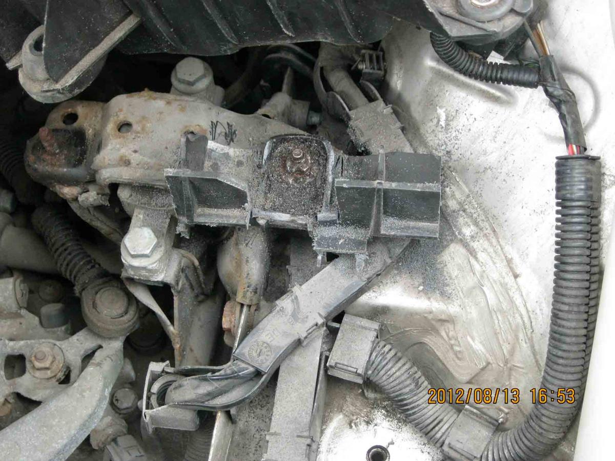

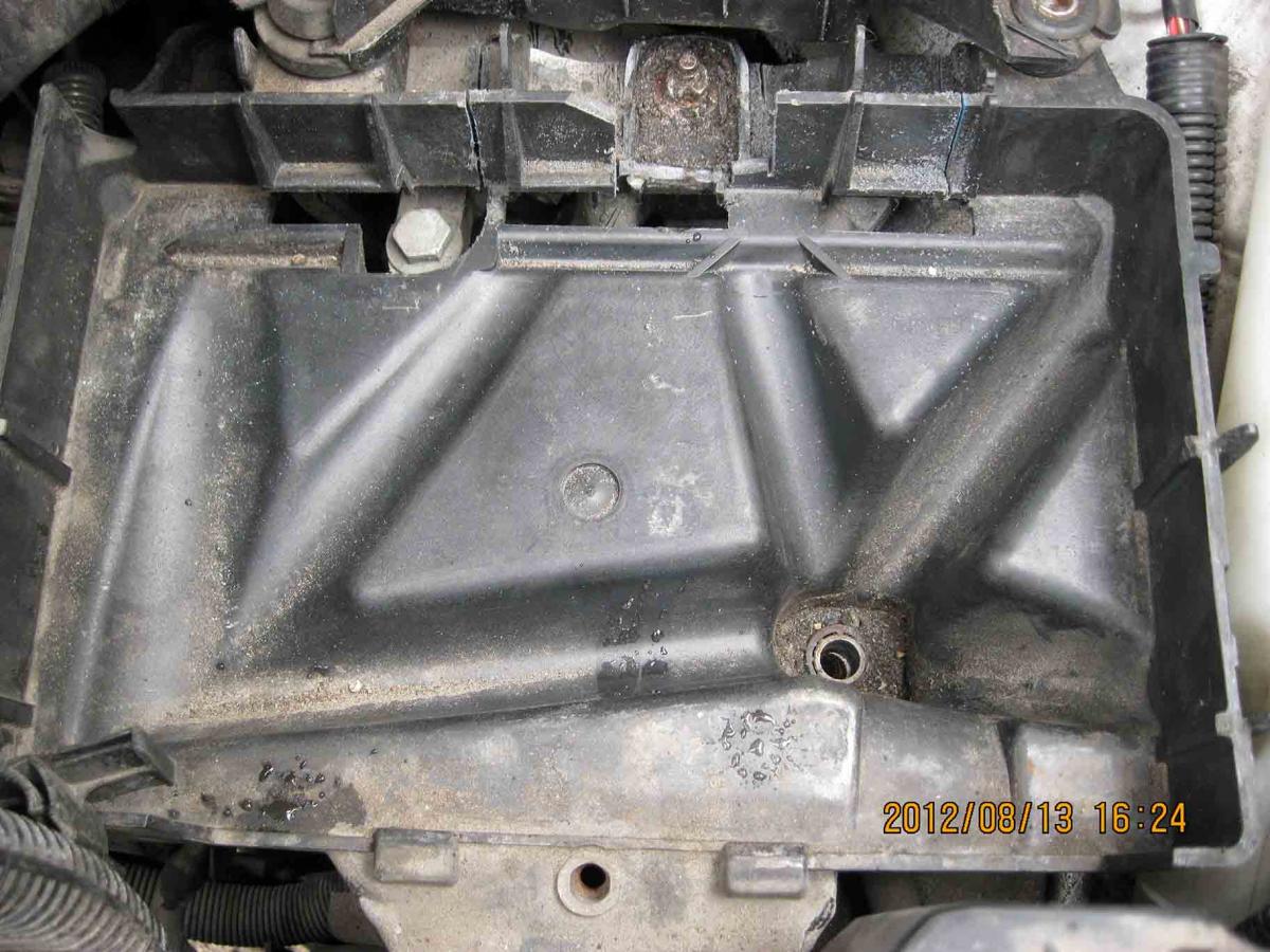

As you can see I went through a bit of trouble getting to it.

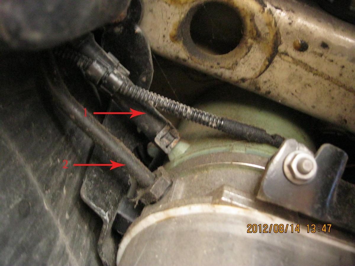

From which end (1 or 2) do I disconnect the pipe to drain the fluid? Please see attached picture.
Also is it better to drain from the same pipe where it extends under the front wheel arch.
