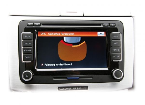

OPS (Optical Parking System) with just rear sensors?
Looking to retro-fit OPS onto SWMBO's TT (2010 with RNS E)
So far the only info I can find says I need front and rear sensors to get the OPS display up on the head unit:
Has anyone got this display with just the factory fit rear sensors?
If you have do you know the part No. for the Parking Controller? ideally a scan with the long coding would be good also.
The car has factory fit rear sensors and I know the controller will need changing, but to what I am not sure.
TIA
You won't get that picture with just rear sensors fitted. You'll just get the back if the car, but it will be actually facing the same direction as the actual car.
Like this:
The picture you show is for cars with front & rear sensors.
There are numerous threads in this forum that say 'it can't be done, and one which clearly proves that (with much effort) it can be.
Factors to consider include which sensors you have as well as which controller.
