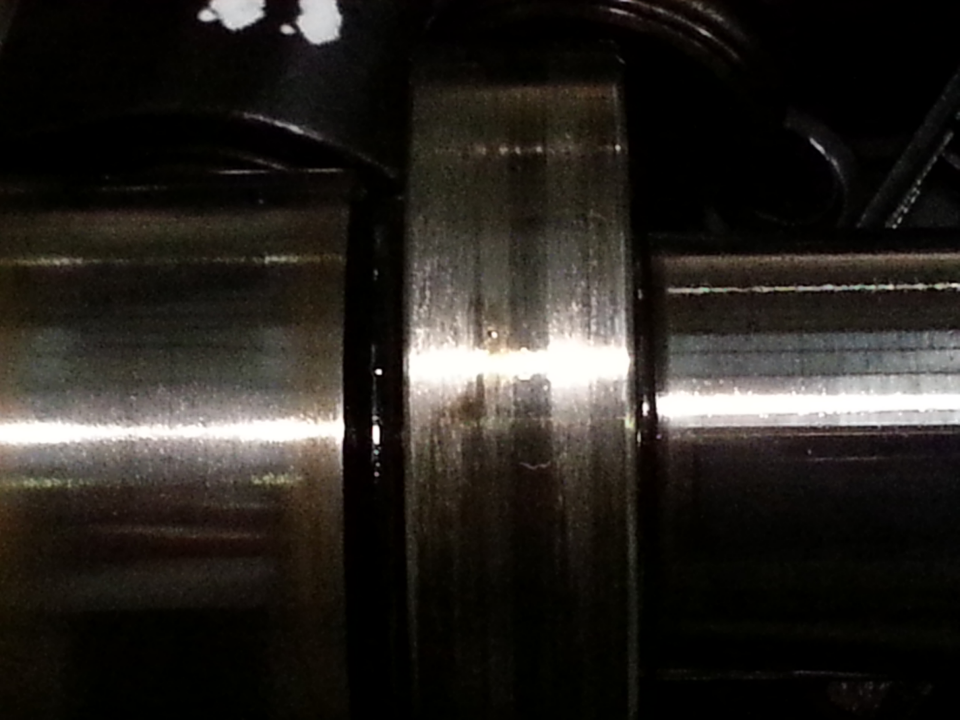

1.9tdi with 127k miles. The mechanics are trustworthy, I felt the followers and they're definitely worn.... Here's one of the camshaft lobes.

Ask them to check the oil pressure and if necessary the oil pickup. The 1.9 has the same reliable chain driven oil pump as the Octavia, but they do occasionally have problems.
Poor oil flow to the head may be the cause of all your problems.

Nope, no symptoms. It's just as they were doing the head they noticed this - best to get it done now than to risk a dropped valve.
Sounds a bit sus to me. For the car to exhibit no symptoms and for there to be excessive wear. I bet there are thousands of this engine out there with the same wear pattern. As has already been mentioned, sounds a bit overzealous.
