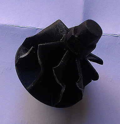

So, turbo replaced.
Cat fine, intercooler fine :blush:
£1280 total :sweat:
A big big thank you to those who offered advice:
Exhibit 1 m'lud:
