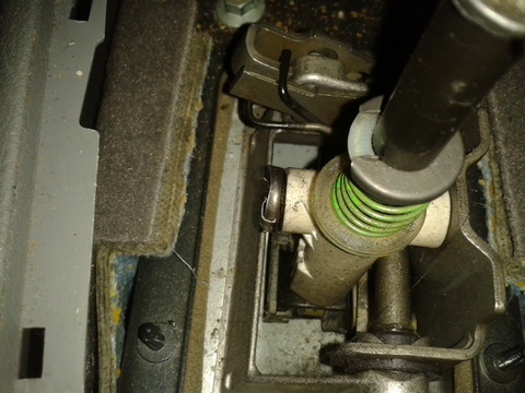

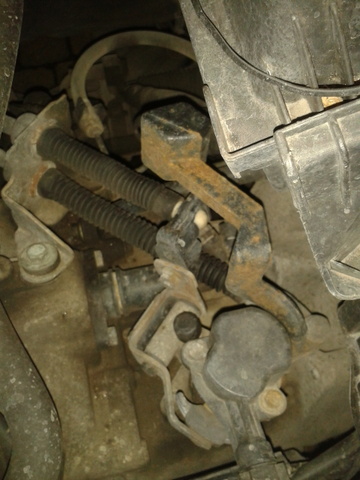

I have a problem. As you will see in the images my gear leaver and selector stock are different. There is no hole on the gear leaver to lock it in the home position and there is no lock key on the stock. Also I cant see a way of adjusting the slack on the cables.
