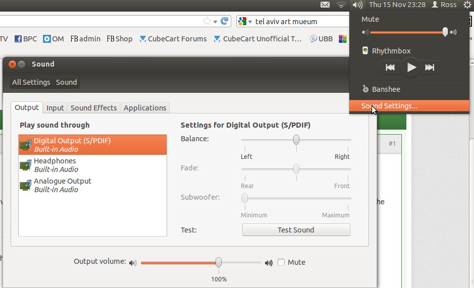

Have you tried going into the sound settings? You can mute the normal output & headphone outputs separately.
Thanks for the reply. Yeah, I've looked in there and all I've got is the attached. If I mute the buttom option all sound stops. If I select the top option, I hear nothing (as it's not connected). That's what's throwing me, there's no differentation between outputs.
Edited by TriggerFish
Trigger, with the headphone plugged in and some music playing, can you then see your headphone controls shown in the sound settings? Headphone will only show up when the headphones are in use. Does the sound 'test' button give you a normal sound test if you use that. If you cannot adjust it from there then read on.

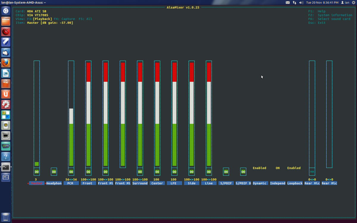

There are some other controls buried in the depths on the OS. I'm not sure if they will tell you anything but it is worth checking. Open a Terminal...use Ctr > Alt > T to do this. Then type: 'alsamixer' (no quotes) and press enter. You should see something like the picture below, but for a 'Stereo System'. There may be something in there that is switched on and it shouldn't be. Probably it's the 'surround sound' setting that is on and it should be off if you are on a laptop. To switch it off use the left and right arrows on your keyboard to move the red selector along the row of settings. Select 'surround sound' and push the 'M' button. This will turn of the surround sound. This should solve your problem. You don't need surround sound on your laptop, it's for 5.1 sound etc. Post back if you still have a problem. Good luck.
