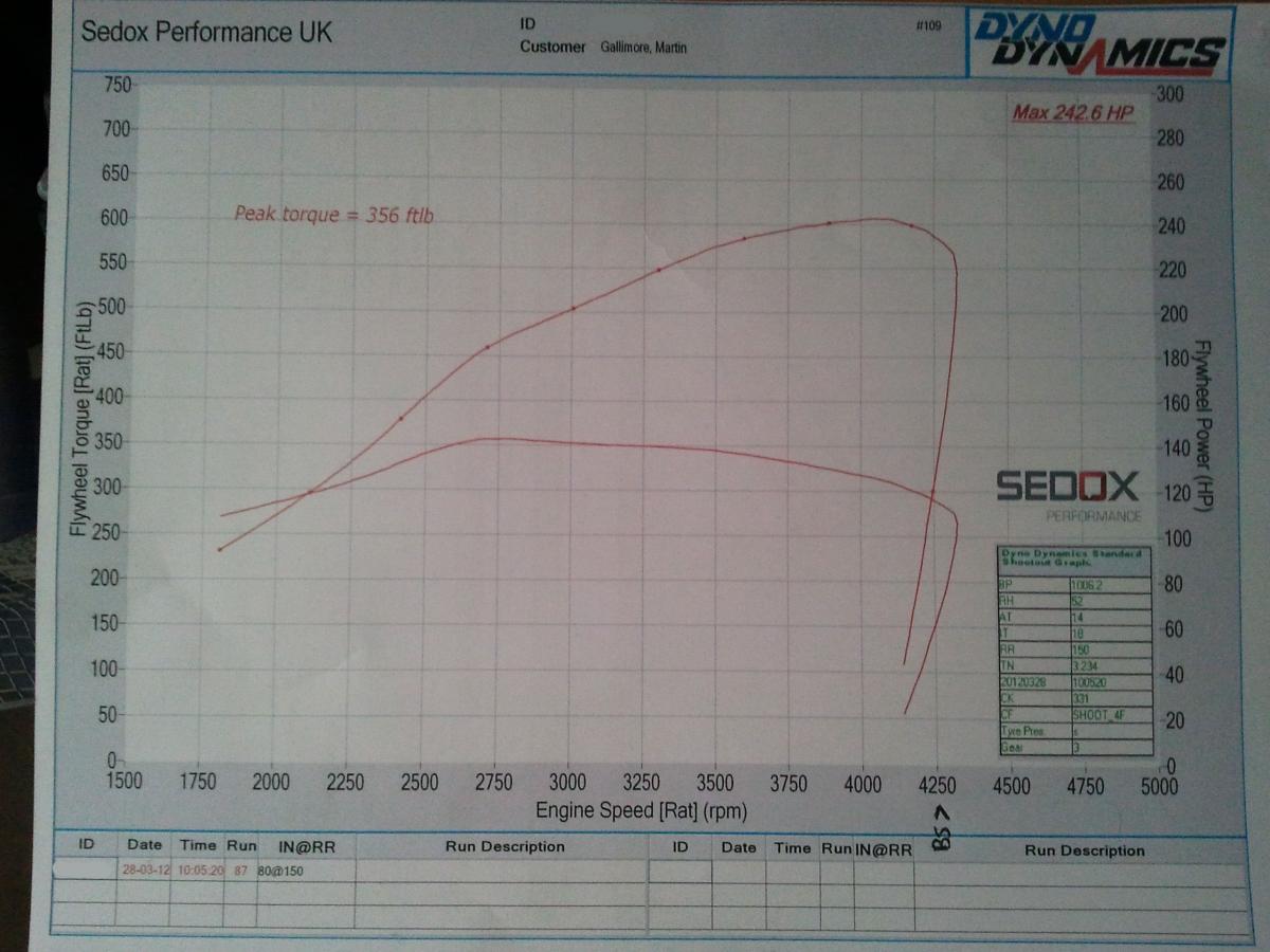

Nice power! What spec is it for that?
Hey
Currently:
MD376 Stage 2 Hybrid
PD160 Trumpet + Smoothed Box
BMC Panel Filter
Ported + Flowed Head (CNC Heads Exchange)
Bosio Race 783 Injector Nozzles
Seat Sport Intercooler + Hard Pipework
Breather To Atmosphere
Miltek Turbo Back Exhaust Hi-Flow Cat + Rear Silencer Removed
Allard Egr Delete
Sachs Clutch and Duel Mass Flywheel Rated To 405lb
/// Brakes, Suspension, Gauges Fitted / Audio System Sub + 2 Amps Sound Deadened Car (Except Roof) ///
