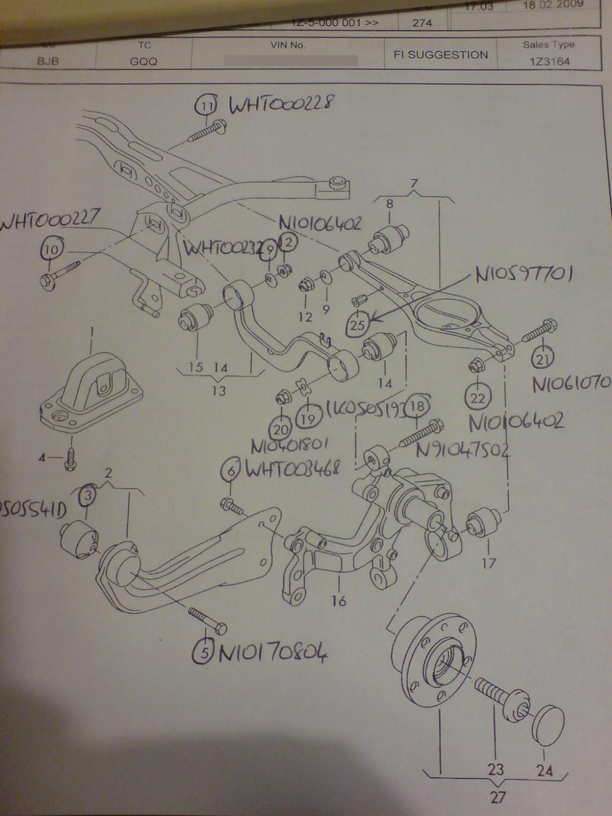

ive found this pic from the part no. sectionpost-48213-0-56457200-1354656005_thumb.jpg
when i was underneath with mech he showed me the bolts that were siezed up ,on the diagram it is bolt 11, through bush 8 in part 7
part 7 i presume is lower suspension arm, bolt 11 eccentric bolt , this is the bolt that adjusts the camber i think. it is rusted quite solid in the metal bush lining and he didnt want to crack it off and split the bush.
next he showed me the other bolt that was siezed for the toe correction and i couldnt really see it very well , so can someone point them out for me on the diagram it looked like it was up past the spring above where the anti roll bar attaches , but im not sure.
edit ive just looked at diagram again and it looks like bolt 10 is the eccentric bolt for toe adjustment and it is siezed in bush 15 which is housed in part 13.

I was in a dealer about the very same thing. The bush is not available separately but comes complete with the arm and hub centric bolt. I'm in Ireland and was quoted €80+vat each side for the parts.
