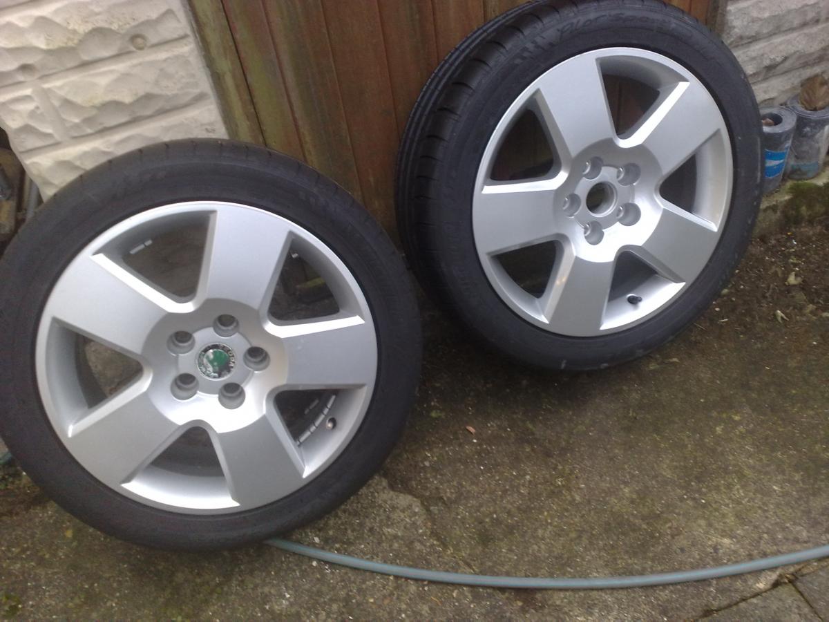

Just as an aside I have a couple of alloy wheels and tyres for the Mk1 Skoda Superb Elegance 17".
Tyres are as good as new - alloys excellent also - any one interested would need to collect from Sittingbourne Kent.

Will be away now for New Year - will try to put pics up after hols next week - Tyre size is the normal V6 17x225x45.
Have now taken pics but how do I upload onto this site (Thread) for all to see.
One alloy and tyre are brand new never been used and the other alloy is in excellent condition (no scuffs) and tyre at least 50% if not more.
Tyres are Michelin Pilot Sport 225x45x17.
I fno reasonable offers - will put on Ebay.
Just sorted out putting pics on.
Please see attached.
