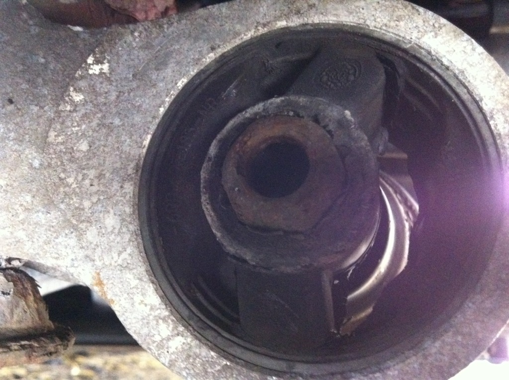

Hi guys,
as above. Do you think it might be bushes or a problem with the arm? When i hit a pothole i can hear a sharp "squeak"
Will be getting it up on a ramp and looked at in the new year...
Thanks
Edited by Beancounter1980
If it's the bushes put it on full lock to the opposite side you're checking and look at the console bush.
If looks like the top/bottom of ghat it's FUBAR, you should be able to see it quite easily. While you're at it visually check the springs and drop links and ARB bushes.
