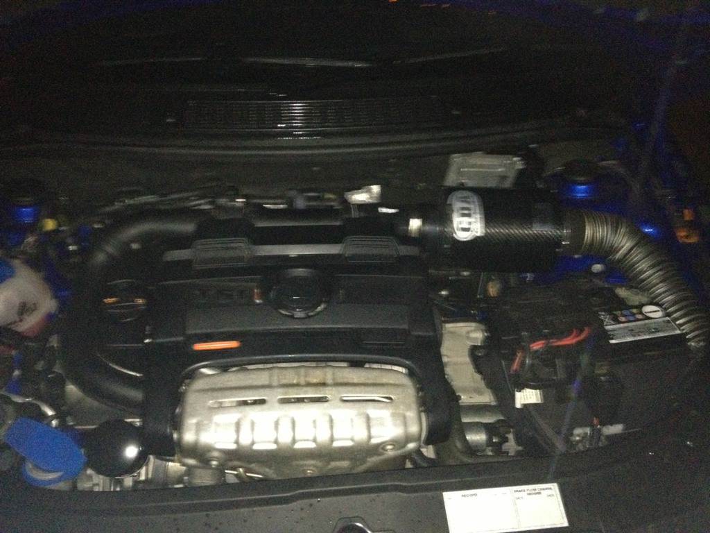

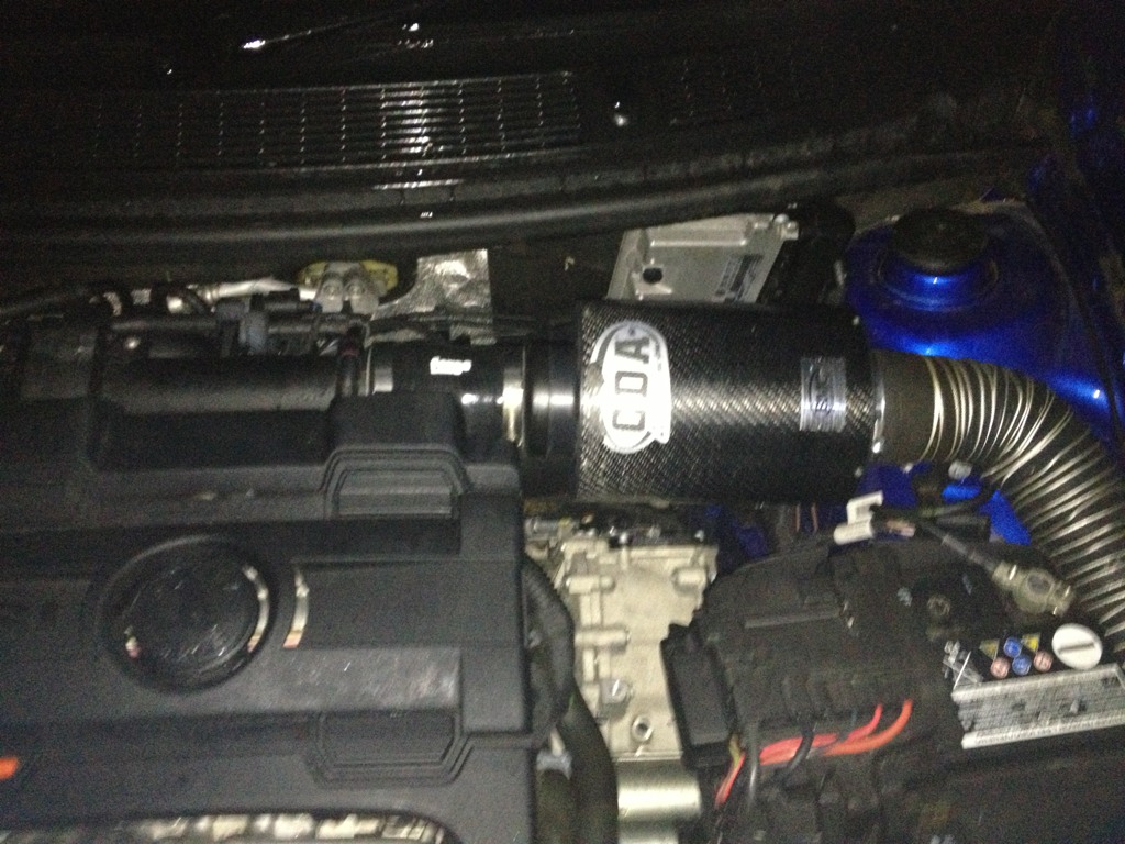

However..I already had a forge one which I purchased off eBay but didn't like it and didn't give any real power gains and I couldn't face paying £300 for the itg so after a bit of research I stumbled across a bmc cda on eBay for £12,it was the box and filter only so I used the piping off the forge kit and all fitted nicely,sounds and go really well hopefully I'll get some pics up soon.
Pics pics!!
As promised a couple of pics,sorry if its a bit dark
Thats pretty much the same filter/canister as used in the Forge kit so surely if the forge offered you no real gains(just as i experienced as well) , then surely neither will this?
Not sure about the duct route. Your attempting to pick up air from behind the battery. I had a look at this before deciding whether to buy the Fabia version of the ITG or get the Polo version and from what i can see there is no flow of air present there as there is in the likes of the Octavia vRS and Golf GTI which have air flow from the lower bumper to that exact point whereas in the Fabia that area has no flow from the lower bumper and no flow from the front of the slam panel, only hot air that is circulating around the engine bay. Might be wrth looking into running a duct from the lower bumper area to ensure a good amount of cool air is forced into that area.
Cold air comes in from through the grill where the oem air box got air from,I understand that it will be getting warm air aswell but that set up is just for starters,I'm going to get some more ducting in the next week or so,as for the same as the forge kit,it really isn't the cda is wider and longer with a better filter in it
Have you felt the engine bay after a spirited drive. Its very very hot it certainly doesnt feel like its awash with cool air. If you start ingesting hot air you'll lose power. They

It will be hot tho when it's idle,I'm thinking of putting some air vents in the bonnet
Im was about opening the bonnet immediately after driving it and then feeling it, not letting it idle and heat up with no air flow.
Must say, im not a fan of air vents, spoilers, splitters, loud exhausts or anything like that. I like the stealth approach.
Bmc cda is bigger and has a larger opening than the forge kit.
What diameter is that pipework?? Looks no where near the 4" diameter of the Itg kits.
It is worth investing in one of these for taking temps under the bonnet once winter is over.
Fridge thermometer £2.75 from Amazon just now.
You can get a 70mm - 130mm and you can also get a 85mm - 150mm kit. I measured the itg I had and the inlet was 130mm
The one I got is 70-130 fitted nicely
