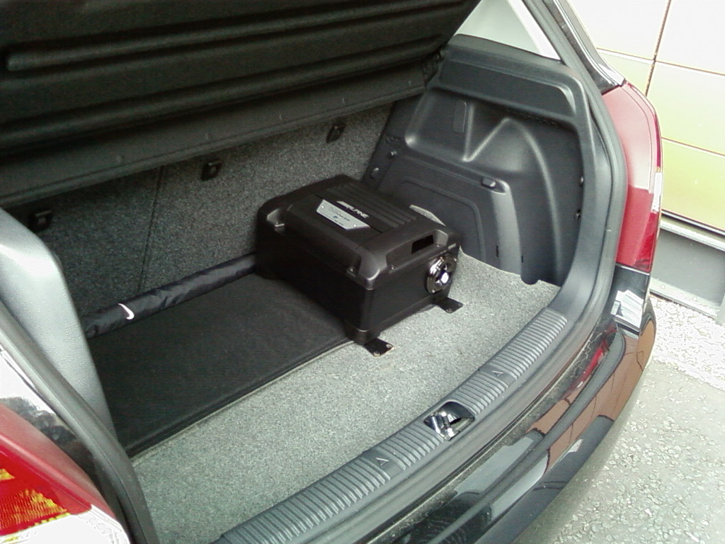

However, if you want good strong bass without your doors rattling like crazy, the best solution is a subwoofer. Finally got a picture of mine.

Thanks FAB59 - nice subwoofer! Did you replace your door speakers too?
Thanks FabFab. I didn't replace the door speakers. What I did was turn the bass to -8 on the headunit, to filter out low frequencies from the door speakers and stop the rattling. That way, I get only mid-range frequencies from the doors and all the bass from the subwoofer in the boot. Works very well.

Thanks fab59 sorry just noticed its an alpine not a RF btw what's the model number on that? And did you buy decent low to RCA converter or just standard cheep eBay jobbie?
Yeap, it's an Alpine SWD-2000. Bought it new back in 2006 for £200. It's only 350W, so it's not the kind that can be heard all around the neighbourhood. It does have quite a punch though, considering its size, but you'd expect it to be good anyway, as any Alpine product. Has got plenty of abuse in 6 years, but sounds just as good as it did the first day I got it. Excellent quality too, a very sturdy build.
It actually came with speaker to RCA cables included, along with T taps to connect them. In the previous car it was in, I had to buy a set of RCA to RCA cables for it.
