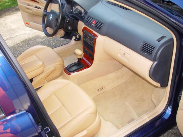

Is that your car?Is like mine,LHD and greeeeeeen :)
No, thats not my car. That is a Pic I found on the net :giggle:
My Car is a 2002 Octavia L&K 1.8T Blue with Cream interior.
