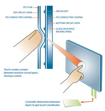

How does it work anyway?
Is it really by pressure of prod?
Or as in real touch screen by electrical pulses from finger tips?

It has definitely resistive overlay hence the screens ''softness''. TBH I'm quite happy with it, it is quite responsive for a resistive touch screen. Incomparable with what Japanese car makers put in their cars.
