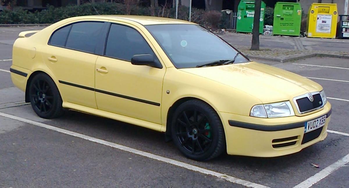

Anyone got any pics side on of their car to show if it does make any noticable difference to the ride height of a VRS.
Also i know 99% of people dont recommend running springs with standard shocks but is anyone doing it and can comment on the ride it gives?

Not the best picture, but should give some sort of idea, H&R -20mm and FSD's

I'm running the H&R springs with standard shocks/struts and no issues at all, even 5 up no rubbing etc.
Will try to get a photo later today.

There we go butchvrs
Looking at that pic thats about how my coillies are set on front and a tad lower on back because they won't go up anymore
Cheers VolvoMeg, I'm a noob when it comes to computer things.
I didn't want the car to low because of the amount of stupid size speed humps around here, plus they provide standard ride comfort but tighten up nicely if you want to push on a little, besides I've got my rally car to play in properly :devil: !
That looks like a good compromise, butchvrs!
Thanks butchvrs, that ride height looks good! What mileage are your shocks on?
Front and rear were replaced at 65k, car now has 116k and are still good, the rears are Gaz adjustables which I fitted because I used to tow the trailer and rally car behind, but the fronts are factory units from Skoda.
same as mine :) sits nice on the stock rims too :)
