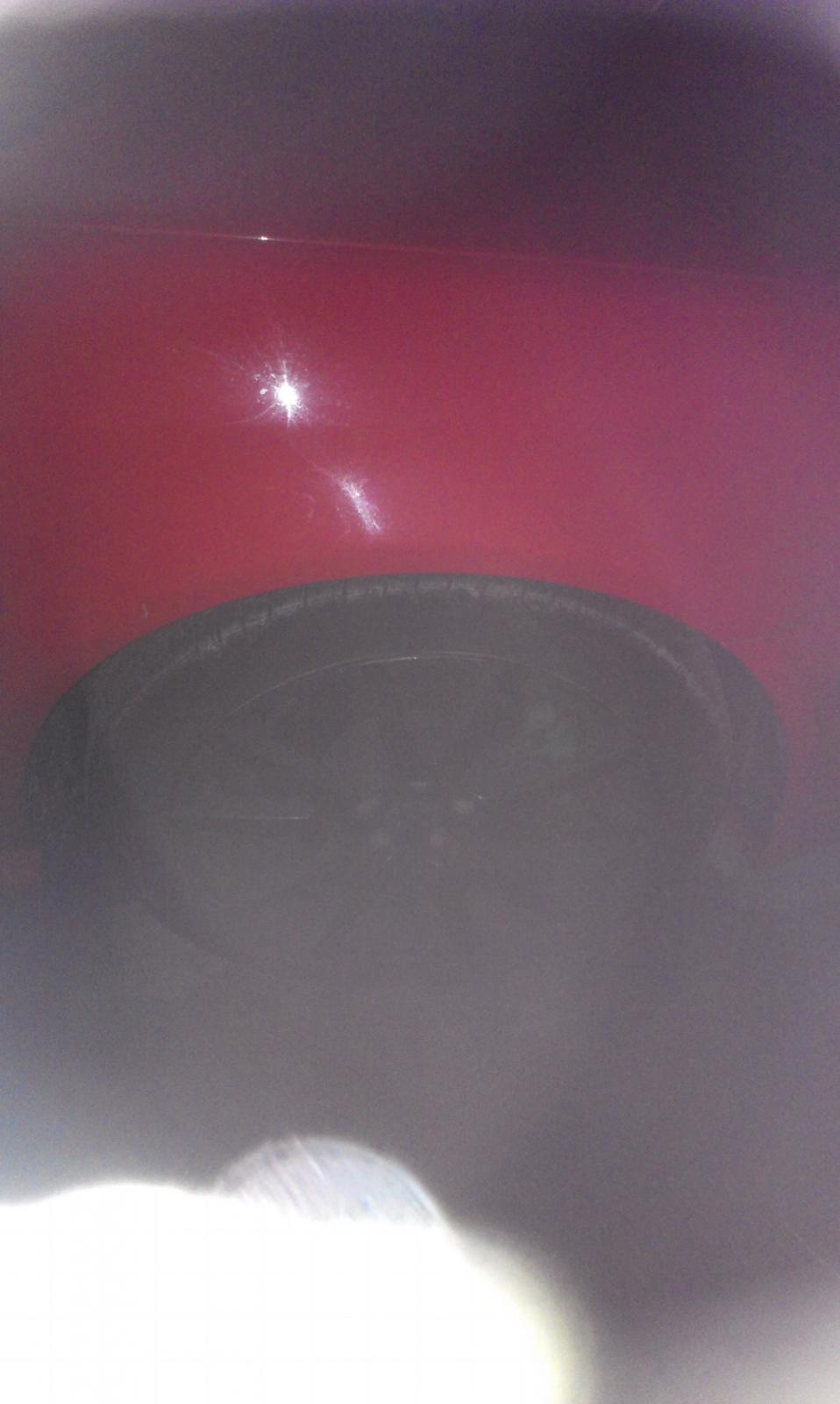

had the pro sports on a few months but the ride is crashy as hell it is very low does anybody that has these no if u wind them up the ride is better
sorry 4 the crap pic does this look to low
Yes if you raise them the ride will improve more spring movement= smoother ride wound down as far as they will go = hard crashy ride and maybe bouncey as well that brings back bad memories of an old r5gtt .

in fairness they have been terrible am driving trying to avoid every bump pot hole as it feels like you been competing in wwe has given wife problems in her shoulder after only being on 3 months and to be honest never felt anything as bad as this as it just feels like i dont have any springs or shocks :S
Most coilovers wound down very low will give poor ride as the rebound capabilities in the shock/strut is compromised. This will certainly be the case in those cheaper pro sports. They will not be up to the job set low. I had this issue even with weitecs and raised those to get a better ride. My KW's can handle being set low though. So if you want a better ride then yes raise them.

The crashy ride is folks have either coilovers wound too low for their working performances or a crud set of cheap coilovers that give folks the ability to make their car slammed but give as much ride support as a brick...
They are not riding the same as weitecs if you are driving like miss daisy and avoiding road imperfections. You don't need to do that with decent coil overs.
If it is all about the look and no ride comfort then get cheap coilovers, if it is about a compromise between a car that is used for kids, work, shopping and distance driving and to look mean then don't get cheap coil overs.

will try and get a better pic up later as i thought it looked very low when it first came out of garage after fitting rarb and the coilies
