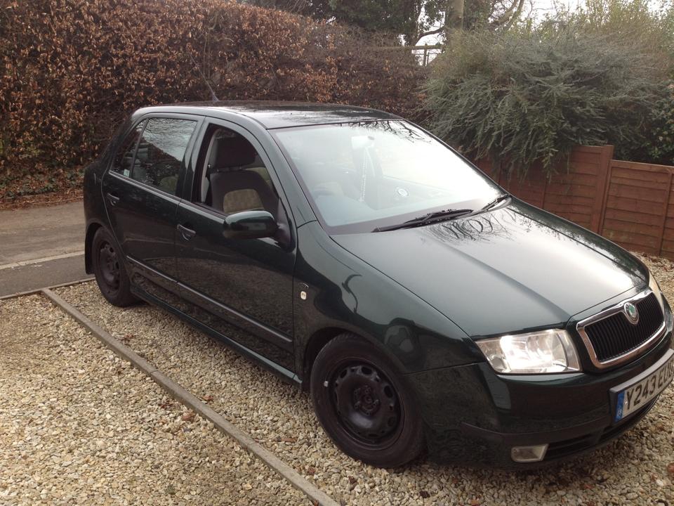

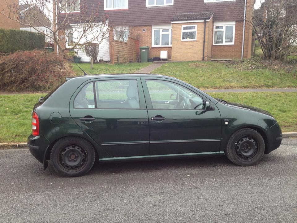

Hi guys i have got JOM coilovers on my fabia now (very first thing i did to it) and getting alloys soon
i just got a slight problem, when i got the coilys on they had to disconnect the anti roll bar because its a bit long because now its lowered it made stupid noises ( so we had to take disconnect it )
what you think guys?
here are some pics of it now
