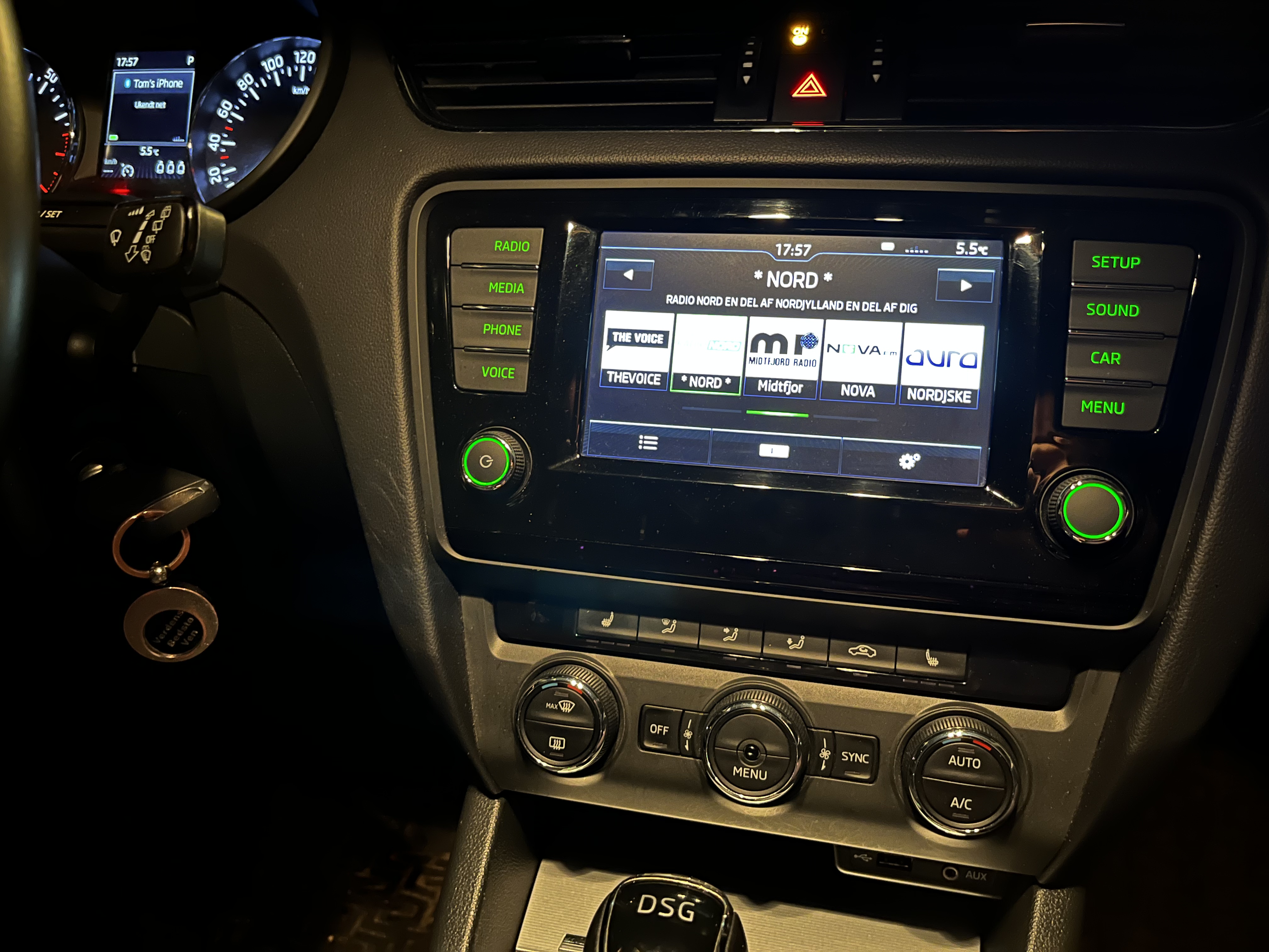

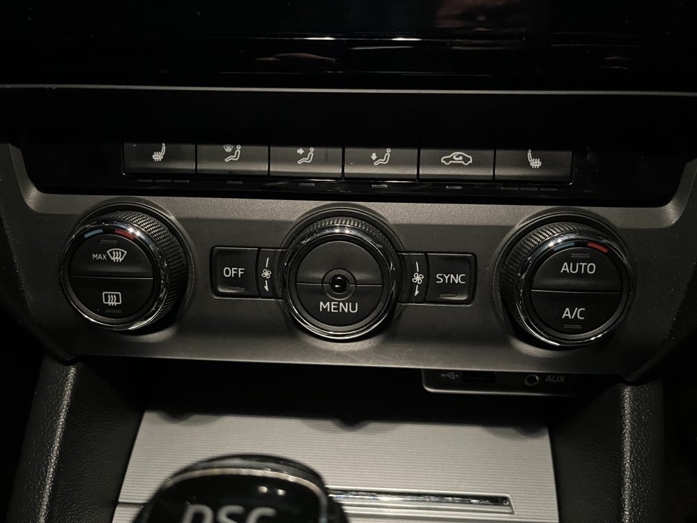

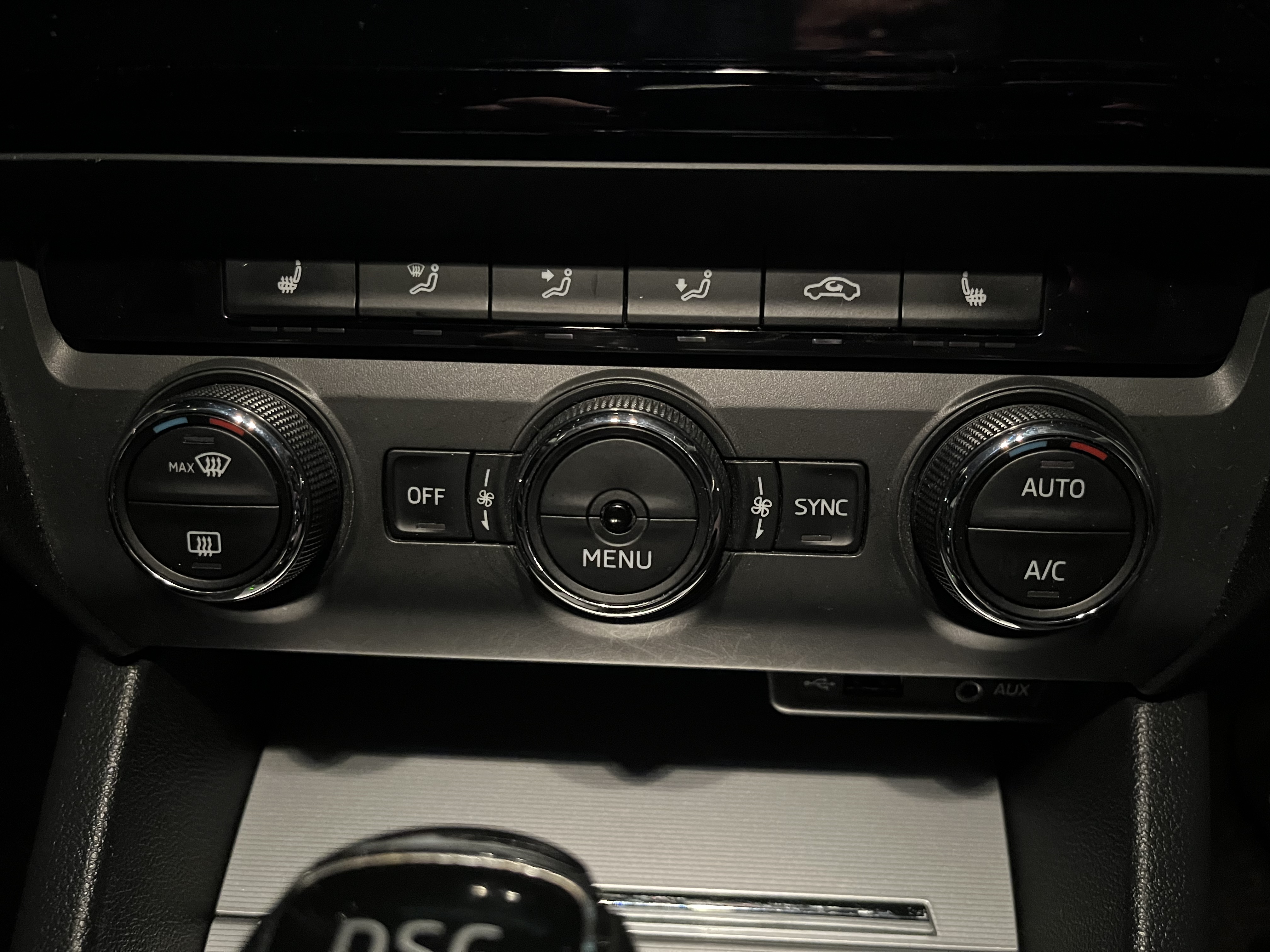

All working fine in my car except for the power to the lower console see the pic. Just showing off
