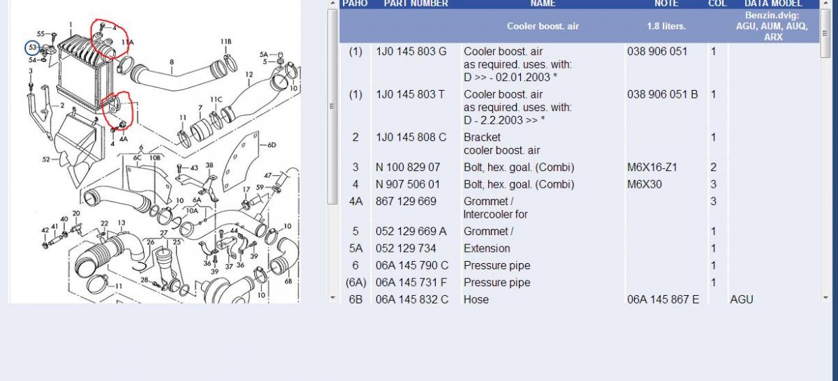

If you use Chrome it will translate the page http://vin-online.ru...at=252&gr=14575

Which PN are you after, Inter cooler itself ?
I presume there is a mount that fixes the mount to the car, I havent got Chrome, will see if firefox can translate it
post-8833-0-65836900-1363186476_thumb.jp
I've circled the mount points, I think it's just those, I don't think theres anything else on the other side.
IIRC the top two are on the plastic top of the IC.
thanks, I think I got confused, I was presuming there was a mount on my car that the intercooler mounted too, and that needed replacing,
can find plenty of intercoolers for my car, no wonder I couldnt find a mount lol...
