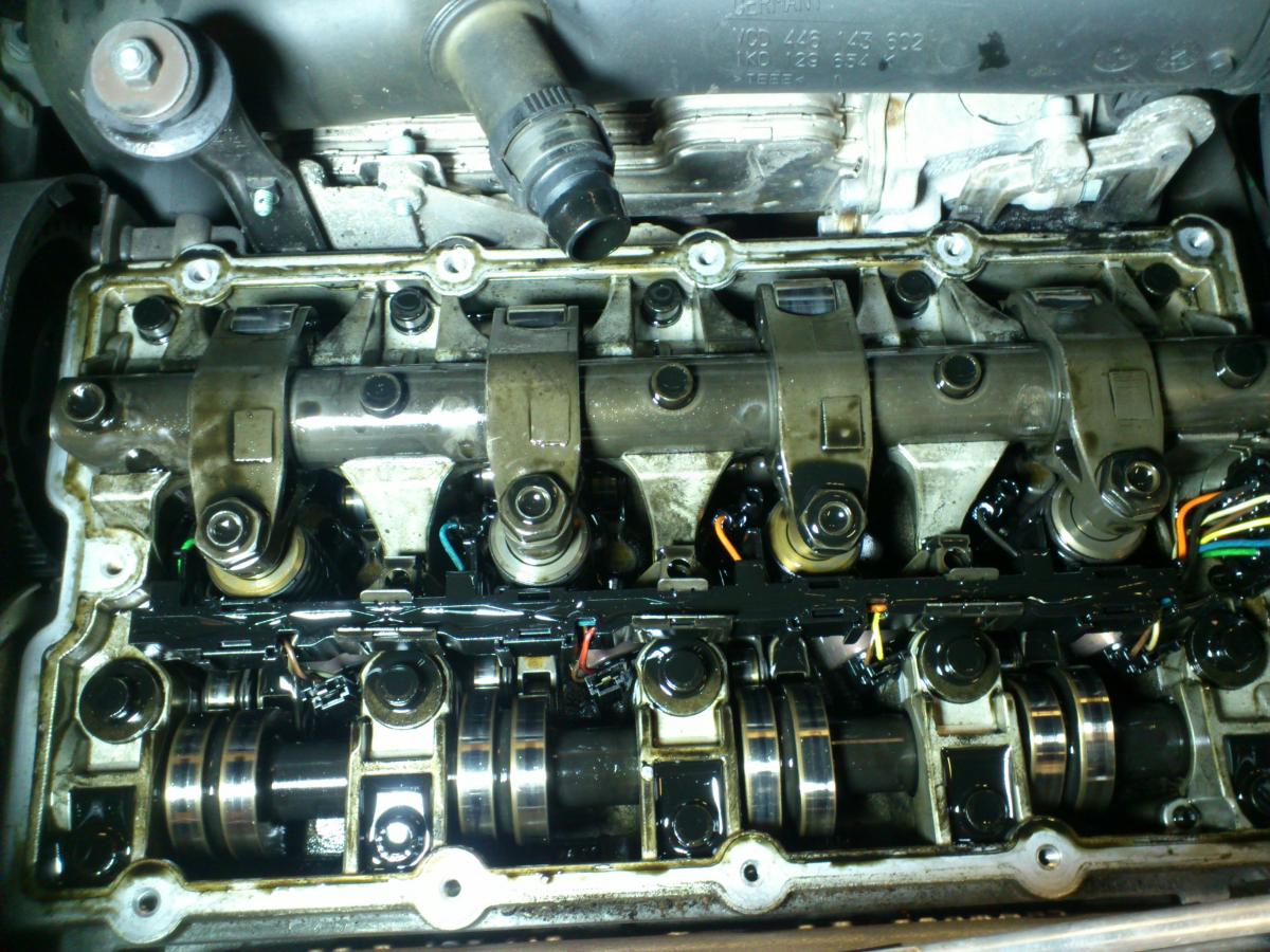

Next lift the cover it can be a bit of a fiddle but gently gently and it will manoeuvre up and off.

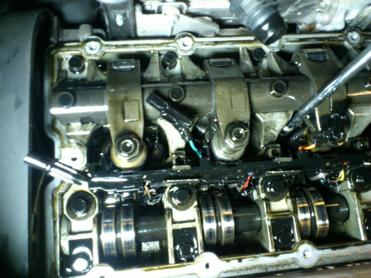

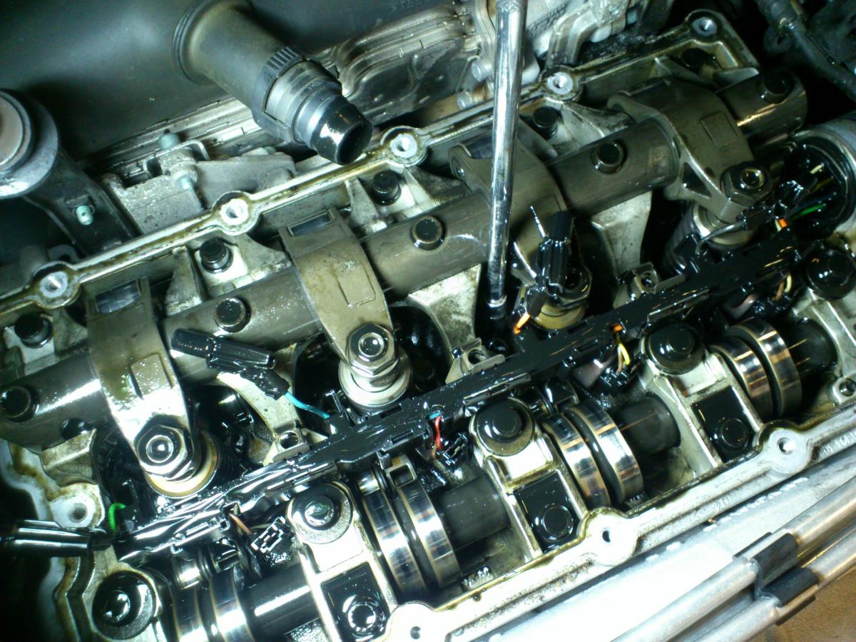

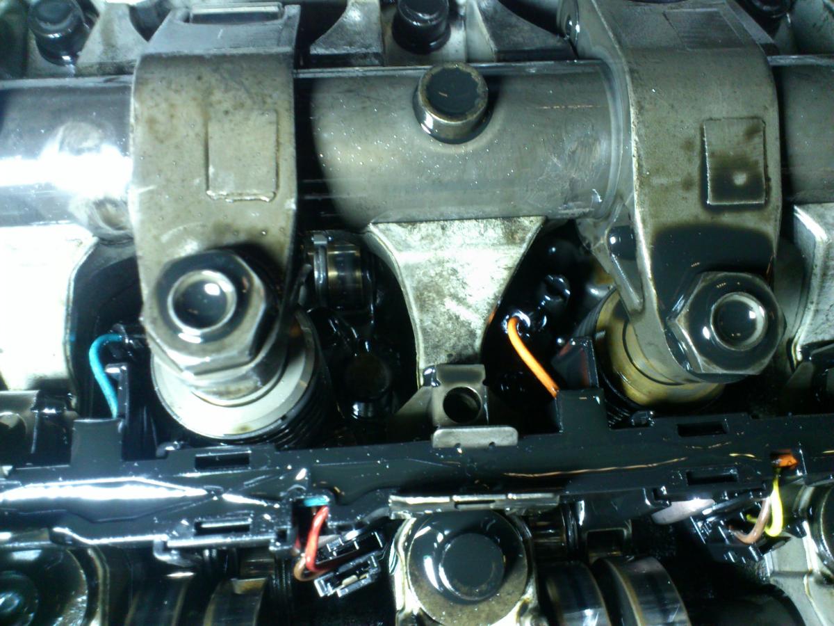

Inside the cover you will see the injector/glow plug harness,follow the wires and you will see they are just pushed on to the top of the glow plugs so carefully using pin nosed pliers grip the push on connector and using a GENTLE lift/twisting motion pull the connector off the glow plugs.
Next using a deep 8mm 1/4" drive socket on an extension loosen the glow plugs and lift them out either using a magnet pick up tool or pin nosed pliers.
Replace the glow plugs ensuring you start them using hand pressure only to ensure you do not cross thread them and just nip them tight,remember you are just in alloy.
Pop the push on connectors back on using pin nosed pliers to locate them on and then a screwdriver or similar to push them home.
