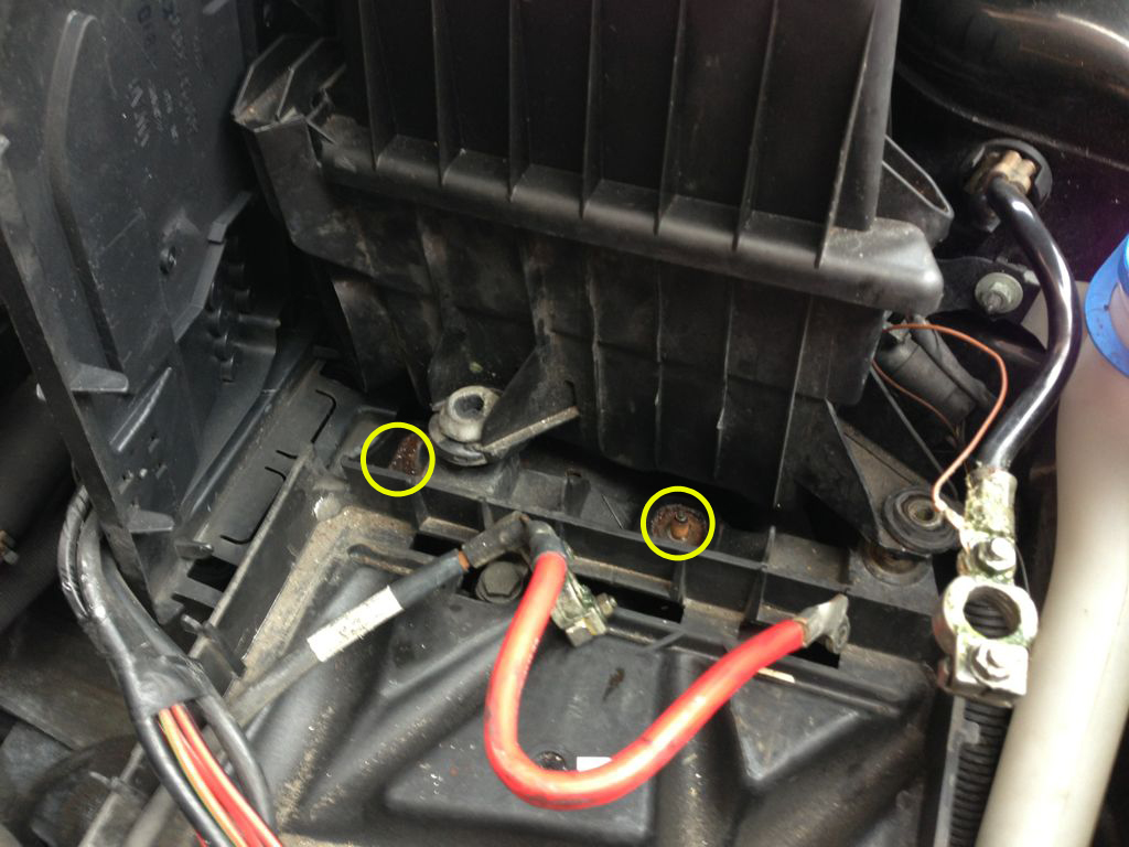

Long shot, but does anyone know what size nuts I'd need that fit onto two screws at the back of the battery cage, under the front of the air filter housing. I've attached a photo for reference.
Had a nightmare removing corroded ones (Thanks to members recommending Irwin bolt remover tools) and I emailed Skoda but they can't find the nuts in their parts catalogue.
If anyone knows what I should order and from where then please let me know!
Thanks :happy:
M8 thread, 13mm head. Should use some large form of washer under it as the OEM nuts have wide flanges spreading the load over the plastic as well as the insert.
Clean them up and grease the hell out of them to reduce likelihood of future corrosion.
