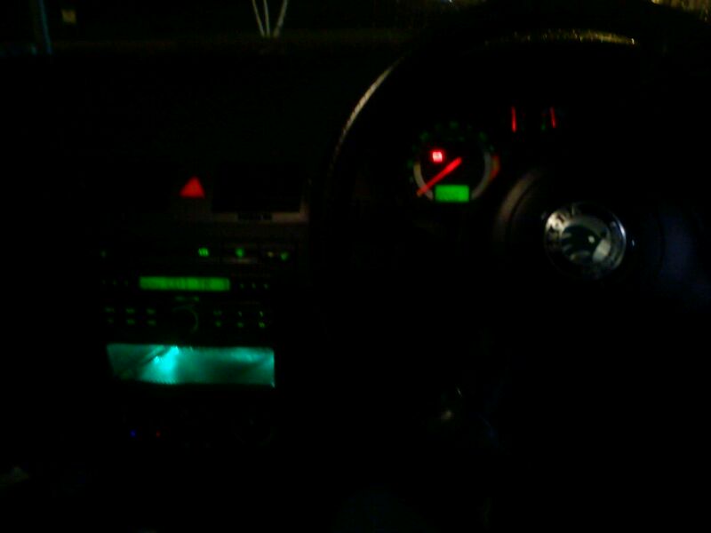

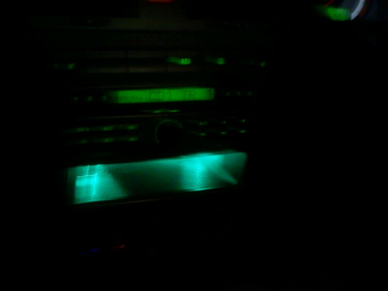

today with the rain i ended up putting some legs in the box below the radio lol
LED's
How you powering them?
i find an ignition live behind the glovebox , ran a 5 amp fuse then a switch in glovebox then too the hole
they draw nearly no power and the ignition live means you can just forget about them and leave them on.
ill be putting similar in the footwells and in some nice dark holes soon. if anyone is interested ill make a little guide up with pics. while im doing it ??
its just alittle something that i have a habbit of doing when i get a few hours of boredom. but always get people commenting when they are in my car and want the same doing too theirs lol
