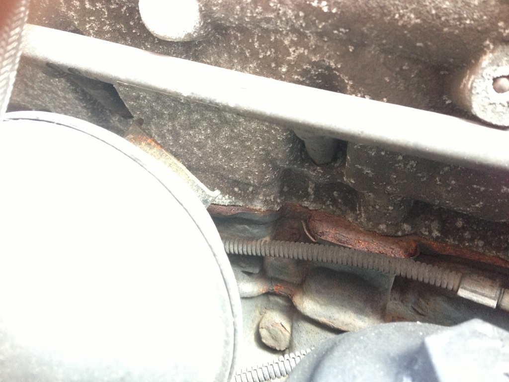

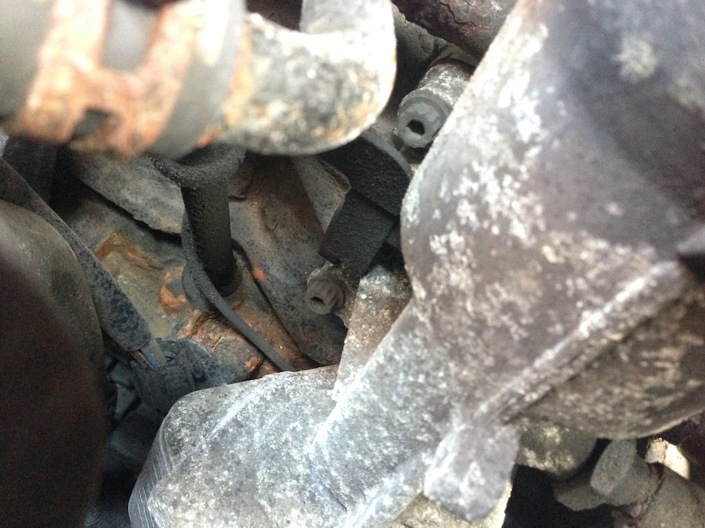

Never noticed quite how rusty the exterior of the engine block is in places. Please see photos. Again, is this perfectly normal for an 8 year old VRS or not? :think:

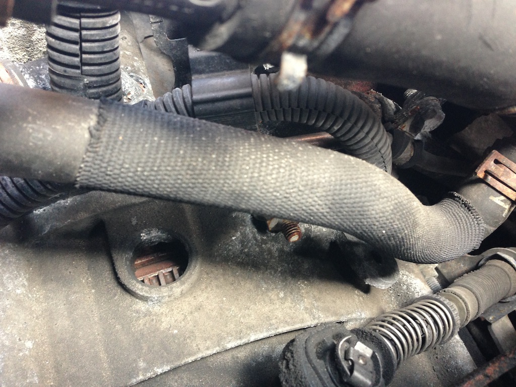

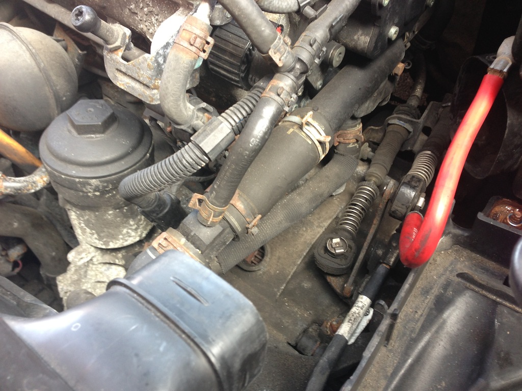

Whilst topping up the steering pump with fluid I noticed a hole that looks like it should be plugged with a cap or something. I want to confirm if it should be topped with something, or if it should be exposed as in the pictures.

Rust - corrosion is not unusual
Hole - there should be a rubber bung. It's taken out so you can see the TDC mark on the flywheel (when changing cambelt, etc). DON'T PUT ANY FLUID IN THE HOLE.
