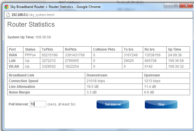

Hi Taylor.
I am assuming you have the Sky Sr101 Router?
If you do open Internet explorer and go to http://192.168.0.1 (Enter the username and password, if not changed it will be on the back of the SR101)
Click on Maintenance
Scroll to bottom of page
Click Show Statistics
When the page loads up copy that information and paste it on here for me to see please. It should look something like this
System Up Time: 109:34:29 Port Status TxPkts RxPkts Collision Pkts Tx b/s Rx b/s Up Time WAN PPPoA 64699839 3387747309 0 98512393 100765174 24:07:09 LAN Up 3269884 2789607 0 49119 719201 109:34:29 WLAN Up 3328705 1821653 0 0 68 109:34:03 Broadband Link Downstream Upstream Connection Speed 21018 kbps 1213 kbps Line Attenuation 18.5 dB 11.4 dB Noise Margin 3.4 dB 9.9 dB
This will tell me what speed your line is syncing up at, It will also tell me what SNR the line has which plays a big factor on speed.
Better still print screen if you can - the copy and paste function does not work right well. It should look like this
