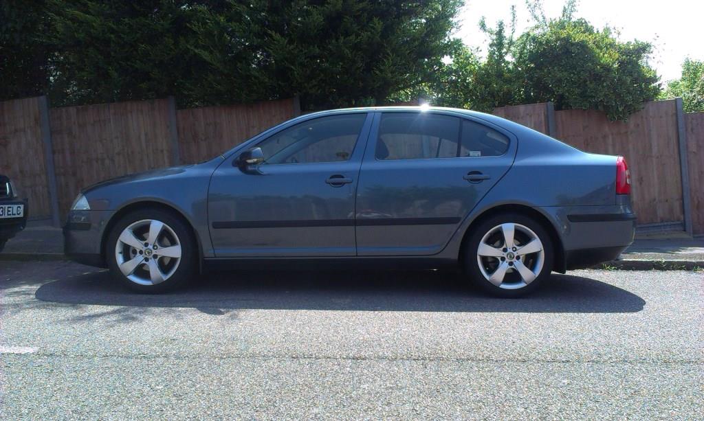

The ride height has settled slightly since the attached photo was taken and now looks to be 10mm lower than the 2UC set up.
