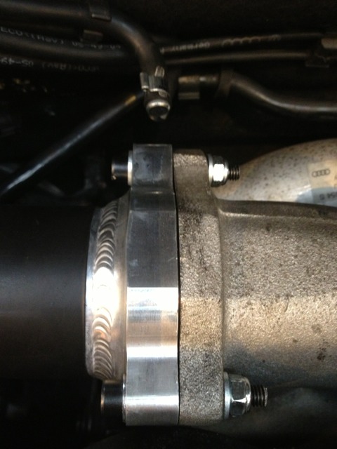

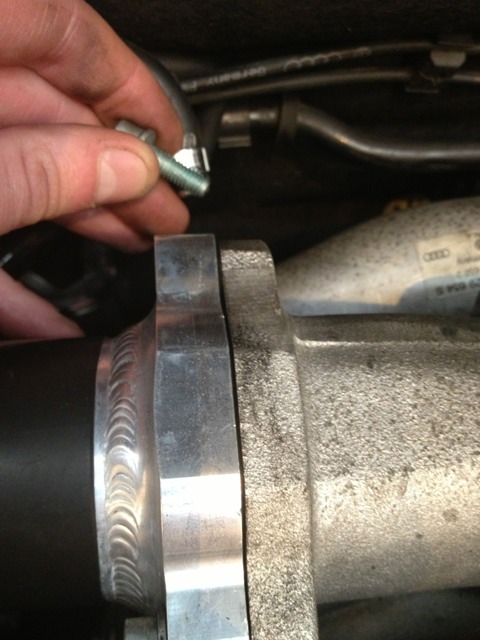

Took off my engine cover this morning to do the elephant mod and I thought y egr delete pipe looked odd, looks like the top bolt nearest the bulkhead had come loose, went to tighten it and its just spinning, pulled it out and it's stripped the thread :( post-102590-13713731293669_thumb.jpg
Should I try a retap? If worse come to worse a nut and nylock would do would n it? :'(
Just stick a nut and bolt through it
As hutchy says, but and bolt = job done.
It's easy to over tighten the egr bolts and the thread gets chewed as you discovered :(
