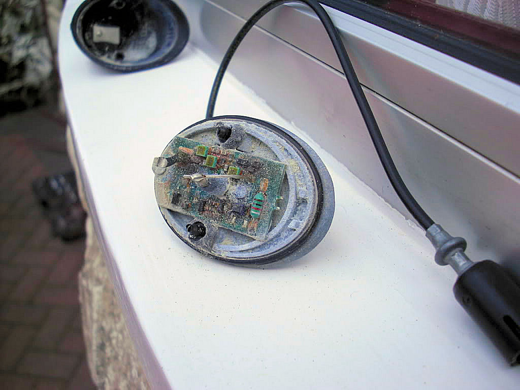

Water gets into the base of the aerial (where it is supposed to be sealed to the roof).The plastic gasket is prone to cracking,or going hard.Inside the cone shape is an aerial amplifier built on a small printed circuit,powered by voltage sent up the aerial cable from the radio.Water is a good conductor,and components ,or the track corrode away.I would look for a replacement base at a Breakers .If its condition looks good (by viewing the base condition ie no white corrosion on the aluminium cover),it will be fine. I have attached a photo
