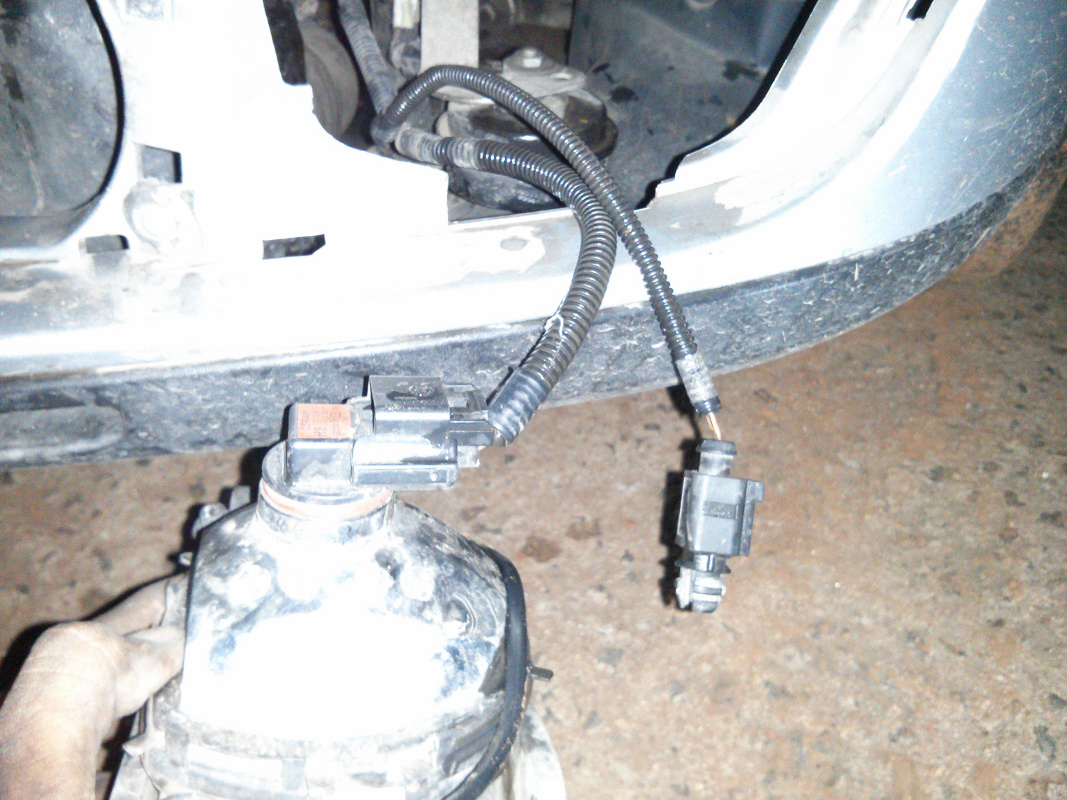

Unkonwn connector near the left fog lamp unplugged (pic inside)
I opened up my left fog lamp to change the bulb and saw that there was an connector that was unplugged/not connected. I was wondering if any one knows what this connector is for?
My car is a pre LCI
External temperature sensor. There is a bracket with a corresponding hole towards the centre of the front bumper.
Thank you :)
I taped the sensor to the bumper. I was wondering why the maxidot was showing the temperatures of around 50 C. This makes sense now
You will need to fix it into a hole just next to the LHS Fog Lamp, pointing outwards so that it is exposed to air outside, else the temperature will still read crazy numbers.
