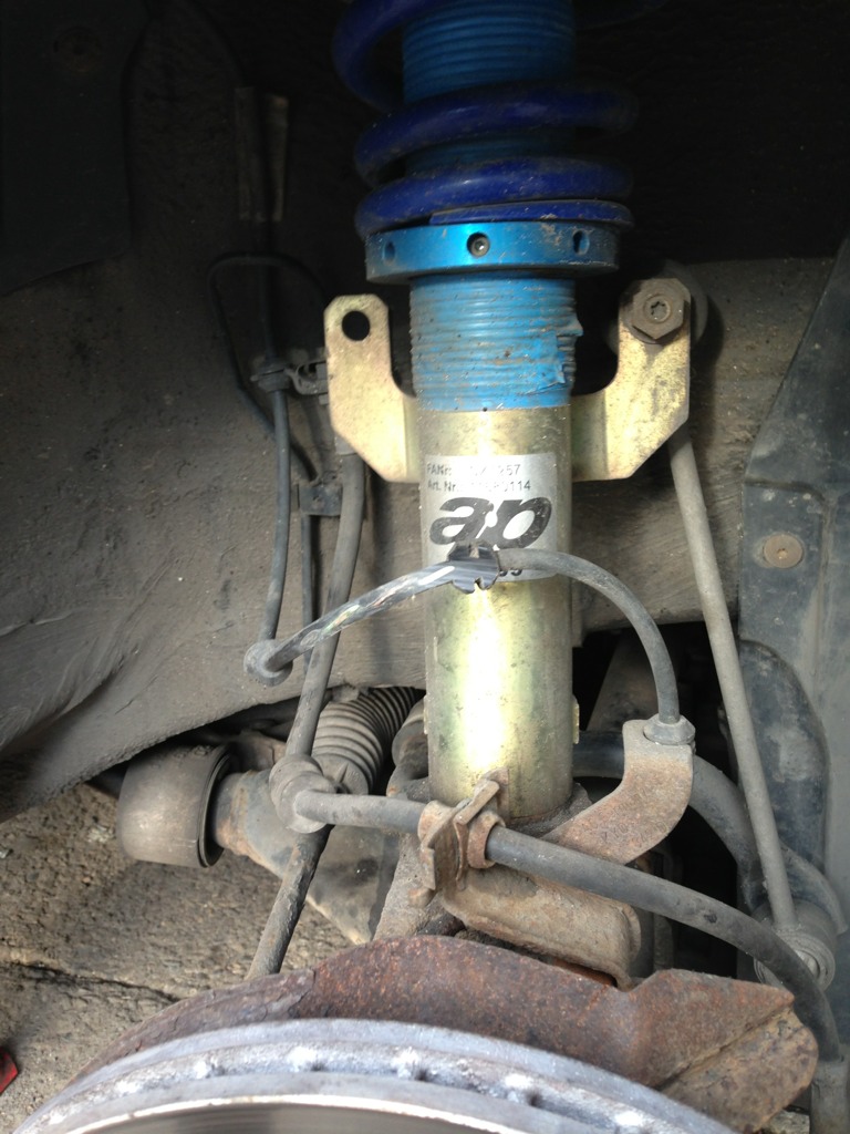

Rubbed through ABS wire.
So I've had my car up on axel stands to bleed the brakes this evening, found the problem why my ABS light keeps popping on and off, any ideas how its fixed and how much? I know I'll need a new wire can you buy them on their own? Thanks
No idea on price of the wiring but Adamweal soldered mine back together after the 3 wires all snapped/split. Holding together nicely. :thumbup:
Thats been rubbing on your tyre
When you solder it back together stick a cable tie around the shock to hold it away from the wheel
It should be round the back of the shock absorber

Yup, thats been fitted the wrong way around, there should also be a bracket fitted to the strut that has two cable clips on it, that hasnt been fitted either.
Should be able to unplug the sensor and reroute the cable. As for the securing clips, they should still be on the old struts
