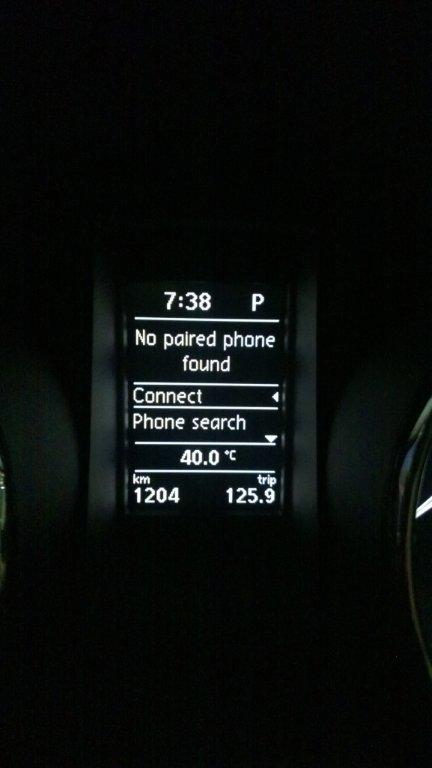

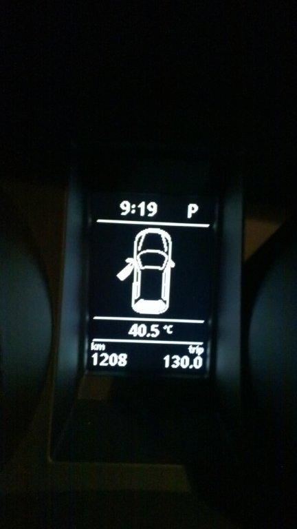

Photos of my outside temperature gauges last evening. note the time. It's not fake!!
Still found Yeti to be doing fine. Perhaps our spec is a bit stronger.

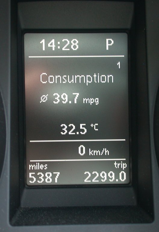

Despite modern hi-tech air conditioning, Annie is being affected by the hot weather - she's going around with her windows rolled down!
Especially for CFB:  This was our best today, above the Chiltern snowline.  We're nearer the sun up here, of course :sun:
