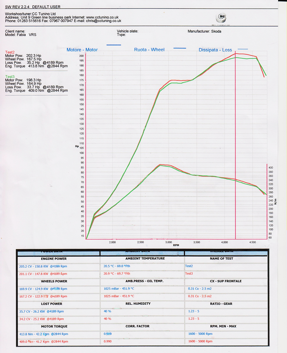

If anyone had turned up they would have seen a pd130 lump run 280bhp+, in tweaking stage lol.
Car stats - PD150 Hybrid Stage 2, turbo back exhaust, fmic, egr delete, map still in tweaking stage.
Looks like a nice map mate :) but aren't stage 2 hybrids supposed the be 220+ ? Not being an arse but don't think I've seen a hybrid put out the power there supposed to yet !
I hit 218 with a stage 2 gt20 pd130 hybrid so the figures are out there!
Maybe Joel's mapped to save his standard clutch.
Looks a dip at 3k rpm!
My leon did this and it turned out to be a fudged MAF sensor!
Id say you maybe have the same issue
With a new MAF i overcame the dip at 3k rpm and gained an extra 12bhp!
Id look at the MAF sensor

Maf has been deleted :think:
does that mean you have actually removed the maf off the car as well or is it just in the map mate? Was thinking about this myself as its a dear doo if they keep going all the time lol
Its still on the car just mapped out.
Mapping is still in very much "tweaking" mode lol. Clutch can handle anything, running a helix. Im after usable power at the moment rather than peak figures. We thought is may be the N75, changed the box and had slight improvements seen via vag com.
Any recommendations on the piping for the n75, tried to silicon but fear now it may be the cause of the problems despite being sold as up for the job !!

Just a quick question the engine torque where it reads 409 nm is that 409 ft-lbs of torque?
converts to 301 FtLb
Cheers, how do you know that, just so I know in future
newton metre to Foot pound convertor on google haha
