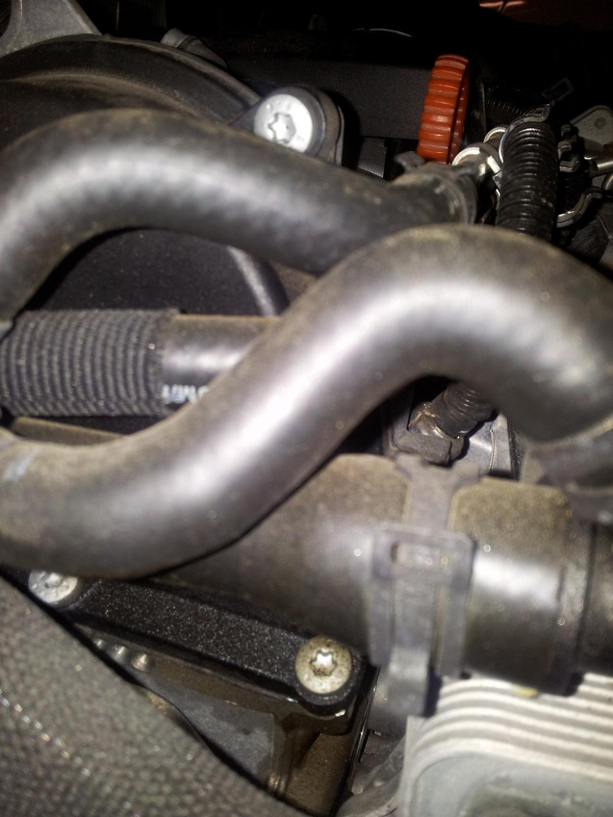

Today when i popped the hood i noticed that i have some oil seeping out from the cam chain cover on the left side of the engine.
It is not very much but still i would have thought a new car came without oil leakage even though it is a small one?
See the picture on how it looks.
I have also noticed a some oil around the "valve" on the intake that seems to have been pushed out around the valve. Not as much as in the picture of the cam chain cover though.
Is there someone else that have noticed this kind of oil leakage on their 1.2 TSI engines? Would it be considerd normal or is it something that i should visit the dealer for?

Had this type of leak with the chain cover on our previous 2010 TSI 85; mind it was two years old and 18k when I first noticed it. If its just very minor I'd leave it to fixed at service.
Brakes then no, no problems as discribed. Again with the previous car the HHC stopped working for a week but cured itself before I got to the dealer; never happened again either :wonder:

I agree with The Plumber, the oil leak is minor and will not cause problems and it will be fine to leave it until next service if you wish, but personally I would be taking a new car back and having these things done as George recommends.
I had a Merc 190E 2.6 many years back and they were noted for a similar leak, it was an older car and as the repair was costly I just left it and kept washing the engine! It never even lowered the level on the dipstick.

Today i removed the oil and i will now keep an eye on it and see if there is a leak and how long it takes before it gets visible.
