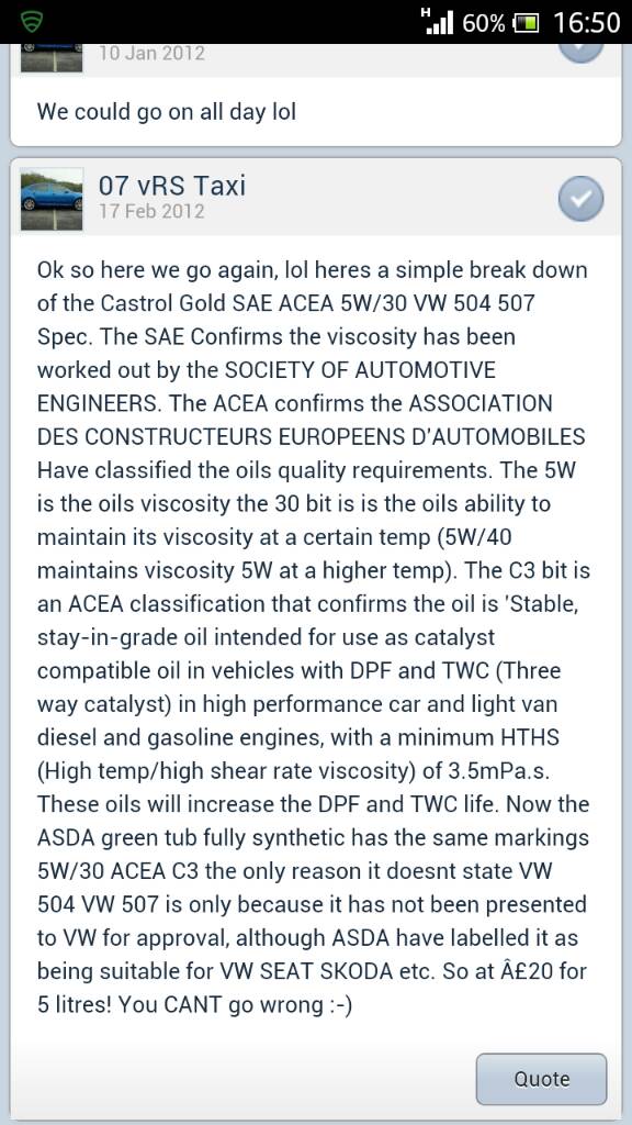

If you want to go cheap buy ASDA 5W/30 in the green tub £20 for 5 litres. It hasn't been presented to VW for approval but it is C3 so it can be used.
Just seen in local Asda their own 5W/30 in the green tub is reduced from £20 to £14 for 5L.  Does say on it suitable for VW and Skodas.  Seems a good price if it is suitable.
It does say suitable for Skodas but hasn't got the VW 505.01 approval simply because it hasn't been presented to VW. But as I said it is 5W30 C3 so it's good to go in.

And me, I go for the next step up I use Triple QX and it has the VW stamp of approval, im not trying to have a pi55ing contest here nor am I trying to say you should use an oil that hasn't been approved and tell a warrenty company that you did use an approved, all im saying is VW don't grade oio ACEA and the SAE do and they say ASDA's 5W30 meets C3 spec, which is the requirement.
