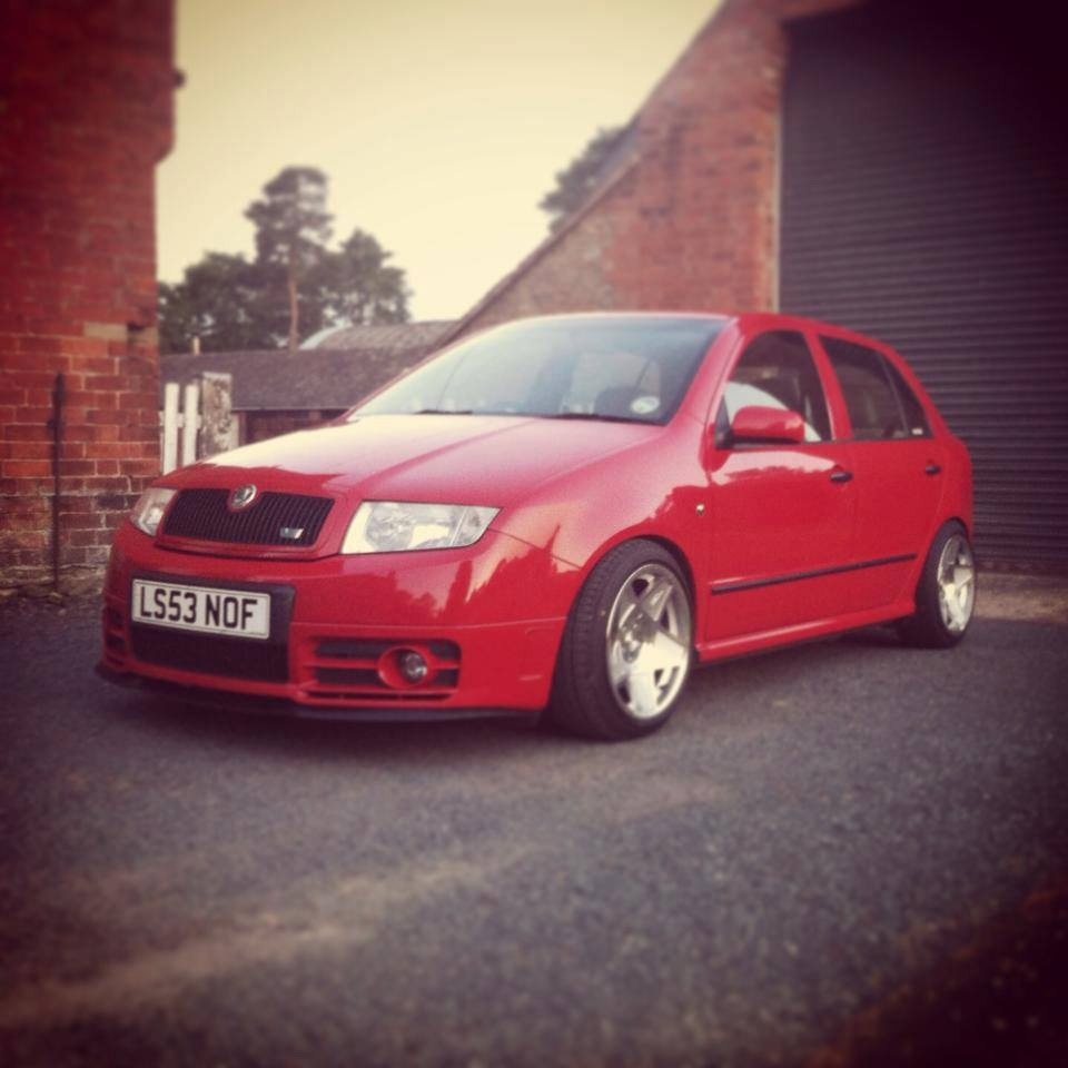

Will look like this... :)
Wheels will stick out miles, foul arches unless very stretched tyres are used, will rub anyway probably and will ruin the handling let alone the steering.
J.
8j et 10 will be fine on the rear but fronts poke abit to much. My fronts are 8j et20ish and sit pretty flush. You could run them but need alot of stretch to make them look good and then alot of lows to make the stretch look good.
Found this on the Slammed Skodas & Dub Facebook page.
Damn that's pretty :(
